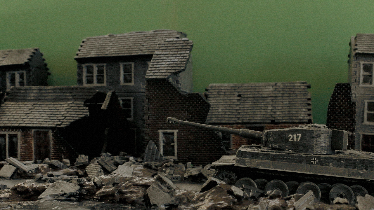

Here is a quick test i did yesterday
Im quite proud of it for a first try although i must admit there is still room for lots of improvement.
I set up the scene in a shoe box which i lined with green paper and then filmed the shot and loaded it into premiere and then into after effects for compositing then back into premiere for sound effects.
Obviously the green screen work needs improving, the green paper i used worked alright but i just placed the scene close to a window and used the light from outside to light the scene so there were a few shadows around the buildings in particular that i couldnt key out (right now i dont really have any lights)
I think the actual movment of the tank could be improved aswell,
Im still very new to after effects so i hope to get better at that with practice too
Would be great to hear some feedback and any advice you might have cause i hope to make a little short film in the near future, thanks.

I just finished another slightly longer sequence after learing a few things and taking abit of advice after the last shot.

You're getting there! I see lots of improvement over the first test.
How many hours did you have involved making your second test movie?
I like the Wallace & Grommet films, but I can't imagine the time it must take to produce a feature like that.
Good luck, and keep us posted on your progress.

In terms of the filming it took me about 4-5 hours to get those 4 shots. The fact that they were tanks made things a little more tedious because they obviously move quite slowly which meant more photos (my first test i didnt take enough frames so they moved too fast in the final result).
Also i used some old bed side lamps to light the scene, i was happy with what they did and they were nice and easy to move around but they were quite dusty so the fumes comming off them gave me a bit of a headache.
I think the colour grade helps quite a bit too by tying all the different elements together
Im making a hillside set where i hope to have a bunker and some german tanks overlooking the town and firing down into it. the basic storyline will be allie tanks moving through the town and trying to take the hill.
