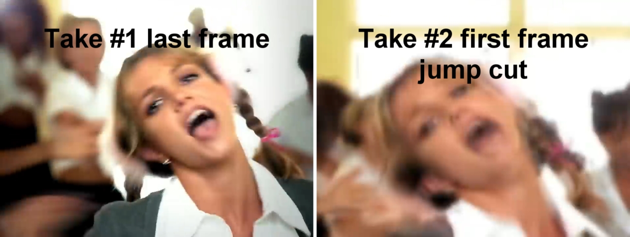

As you say hard to judge on the Tube so I downloaded it.
It's not just a crash zoom out on one continuous take. Two takes are involved. There is a CUT, a jump cut at that, not even close to a match frame cut one frame before a crash out zoom of two frames. The quality of the jump frame directly after the cut is of considerably lower quality than the frame before the cut. To me, it looks like the editor zoomed in to about 70% on the second take and then one frame later crash zoomed two frames back to the full-res wide shot.
With a jump cut like that and a two frame crash out any quality loss is pretty immaterial as it's all over before the eye can absorb any detail. So not too much noticeable quality loss for the viewer. But it is there!
This is how I forensically investigate any video effect if I want to recreate something like it or to learn somene else's tricks and techniques. Like hiding cuts with wipes etc.
Chris Young

If you look at the position and the posture of the dancers in each take there are some noticeable differences which made me think it was done in 3 takes but the download sample is of lower resolution so harder to judge but anyway looks pretty easy to replicate during a shoot.

Oh okay thanks. I couldn't download the video to observe it frame by frame, because the video was too long I was told by google sources, however, I put a camera on a tripod and recorded the video, by aiming the camera at my screen.
I then went through it frame by frame and I see what you mean. 3 takes with jump cuts during the zoom. Thanks!
