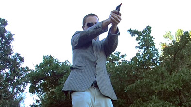

Ok thanks a lot. Unfortunately, the opening footage we shot was in 4:3 as we only had one camera which was (at the time) set at 16:9, bit of a stuff up, so we just kept the 4:3 footage. We were considering re-filming some of it but wasn't sure if it would be worth it.
The footage is mildly overexposed after fiddling with white balance a little bit.
These shots are from raw footage, hoping maybe someone could mess around with them a bit.

Well, there is a big difference between slightly overexposed and completely blown-out skies as you have in your footage. To my eye, your footage is unusable.
You really need to use a polarizing filter and ND filters to control the overexposure. If you have zebras and manual exposure, you might try exposing for the highlights, and then adjusting in post. What camera are you using? Perhaps it doesn't have enough exposure latitude to handle these high-contrast outdoors situations very well.
Also, the 2.35:1 is a large part of the look. 4:3 just isn't going to feel anything like it.
Taking a closer look at those stills, it appears as I described. Everything is quite dull, except for the primary colors, with bright blues, reds, and yellows jumping out. There also seems to be a brown tinge everything else, which is partly production design, but also partly the photography.
You might well-served to reshoot with some of these considerations in mind.
If you'd like to post a number of raw frame grabs from your shoot, I'll try a hand at correcting them and let you know how I did it.

Those frame grabs were raw, untouched. The camera I'm using is a Panasonic GS250 with an Arkon UV filter, but that was for the second image. The first one was from another camera, not exactly sure what it was but I think it was an earlier model of the DCRHC26, and the white balance was significantly off and without filter, making the sky look awfull. I realised theres pretty much no way to fix it, so we were just going to run with it.
We filmed two other scenes in 16:9 and it looks really good, so I think the deep issue might have something to do with that. But also the other stuff was shot at night, and the cameras were balanced for the amount of lighting.
Thanks for your help mate, I'll just have to mess around with it a bit I guess and see what the best result is.

Looks as though you need to white balance as well, your footage has the blues. It seems to be balanced for indoor light. Underexpose slightly and use a color corector in post to bring the mids up a bit. You may want to desaturate as well a bit.

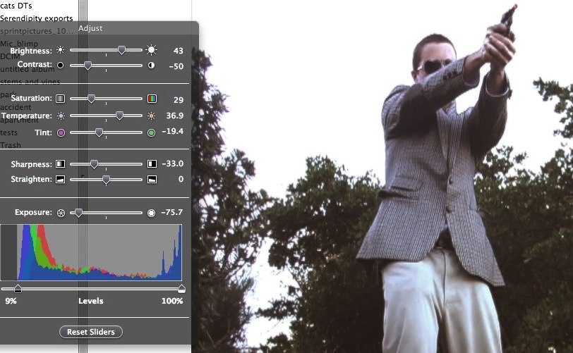

Here's what I was able to get to with iPhoto...part of their look is bright sunlight at obliques angles as well...great use of ambient light.
http://www.dvinfo.net/conf/attachmen...1&d=1150257560

ok thanks that looks much better.

on the DH12 image, the sun is high left side and bounce filled on the dark side of the face to fill out the shadows and bring the light ratio down. The fill light is not so hard as a direct reflector, but more like a white bounce card to diffuse the fill. Contrasting the hard lines form the sunlight...It's also a cloudless day on that pic.
