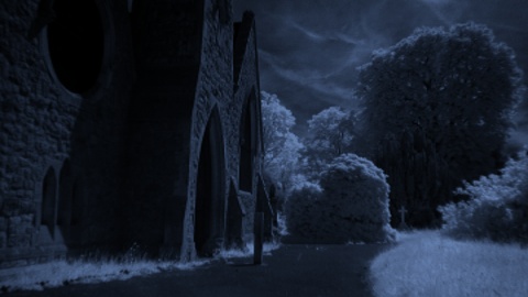

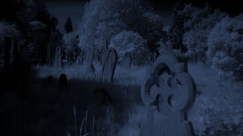

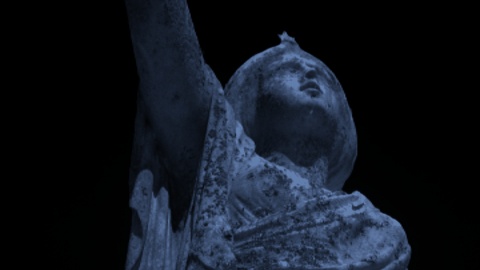

Posts: 90
Infra Red Video
OK, the dancing chicken was an image file post test if you hadn't guessed!
The three images below where taken as part of a vampire video in a graveyard. All used an 1000nm infra red filter, Sony HDV-HC1 and edited in Vegas. I have added Magic Bullets B&W crunch, night filter.
Notice how the sky goes black but the foliage is hotter so it comes out white. Contrast is intensified in stonework, this is all standard photography stuff. I haven't seen any ir HD video on the net though...
Nick.
