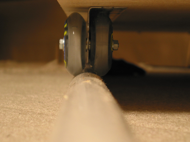

I'm a little lost.
Here's what my wheels look like:
Old November 16th, 2006, 08:38 PM   #42
Location: somerset, kentucky 42501
Posts: 23
Man, you need to clean your carpet..............
Originally Posted by Josh Bass
I'm a little lost.
just kidding. forget the two nuts on the end of the bolt, your bolts are not long enough, rain/x is a superslipery lubricant that goes on your windshield to slide rain off (it is really something to see, no need for wipers over 5mph) I thought it might be cheap (relatively), dry, and not pick up dirt to use to lube the tubes(if it is wheel against tube squeak (known as 'WATS' in the biz).
if it don't squeak under load on concrete (directly on the concrete, no tubes), its not the bearings. most bearing today are sealed lifelong bearings and don't need/use lube anyway.
for three sets of wheels to contact equally _____O____O____O____ the line of the pipe must be absolutly leavel, the ground (any ground or floor) will rarely be, take the middle ones out, then it can't push up in the middle and change the bearing of the front or rear ones. (think, josh, think---dammit jim, I'm a doctor, not a plasma mechanic!)
Jon Whiteford is offline   Reply With Quote

I actually did take the middle set off.
Let me try the it with the washers taken off (the pipe's at a friend's house, so I won't be able to try for a few days), see if that helps.
No, it doesn't squeak on other surfaces, just the pipe.

Hey Josh, I think I know why your wheels squeak - you have both wheels on the same axle, trying to straddle the pipe - when you put weight on the dolly, the wheels are trying to spread apart and ride further down on the pipe. As the wheels rotate, they're "scrubbing" along either side of the pipe, giving the same effect as if you SLID your rubber-soled shoe along the floor instead of ROLLING it.
That design can't work without developing noise - I don't remember where, but I saw another home-built design that puts the wheels in two separate rows, angled so that one set of wheels is at 90 degrees from the OTHER set of wheels, and on separate axles (the bolts you're using) - that way, each set of wheels rides CENTERED on the pipe but NOT in line with each other; instead, the two rows of wheels for each pipe would be at 90 degrees to each other.
I don't have a site to post pix to, or I'd do a sketch to clarify.
I also can't think of any store-bought hardware that could accomplish what I'm talking about without some welding (I do a bit of everything, so this is common for me)
Mainly, I think you're wasting your time trying to get your wheels to stop squeaking as it's built right now - they need to contact the pipe perpendicular to a line that passes through the center of the pipe so they won't "scrub" along their sidewalls.
If I come up with a practical solution I'll find a way to post it somewhere for you... Steve
