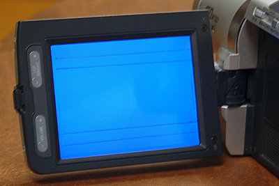

Before I bought my XH-A1, I had this same problem. I got a package of those screen protectors for PDA's, and cut it to the size for my screen, measured out the correct aspect ratio guides and took an Ultra Fine Point SHARPIE and drew the lines on the screen protector. Then I just stuck it on.
Aspect ratio Filter/Lens-dsc09307e.jpg
