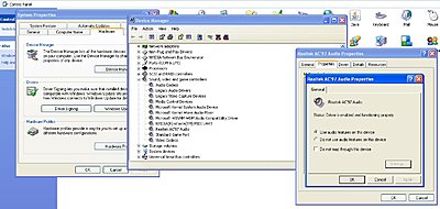

I've definitely enabled SPDIF in Power DVD Ultra and in the main Realtek AC'97 volume settings.
When it comes to applying the SPDIF in the driver settins I'm sort of at a loss though.

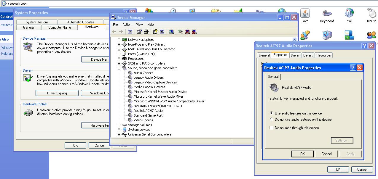

When I click on the device driver in Device Manager, I get as far as the Realtek SC'97 Audio Properties, which enable me to Use or not Use the device or Do Not map through the device - whatever the heck that means...
The most promising button, the Properties button is "greyed out" and cannot be clicked...
Can you advise me any further on this? I'd really appreciate it as I'm starting to feel like I wasted my money on my Blu-Ray & HD DVD drives...

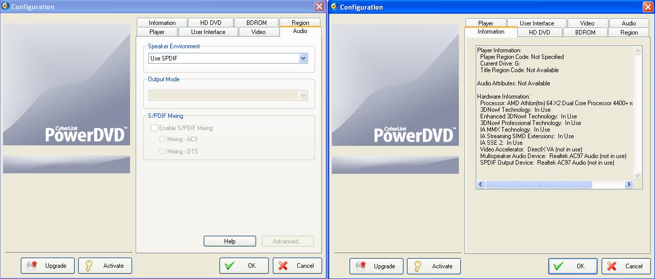

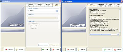

EDIT:
I just looked in the INFORMATION tab of Power DVD Ultra and found that neither the SPDIF not the Realtek AC'97 Audio is apparently being used at all...
I've attached a screenshot of this as well, but I've no idea how to fix it because my Audio Options are "greyed out" in this program too!

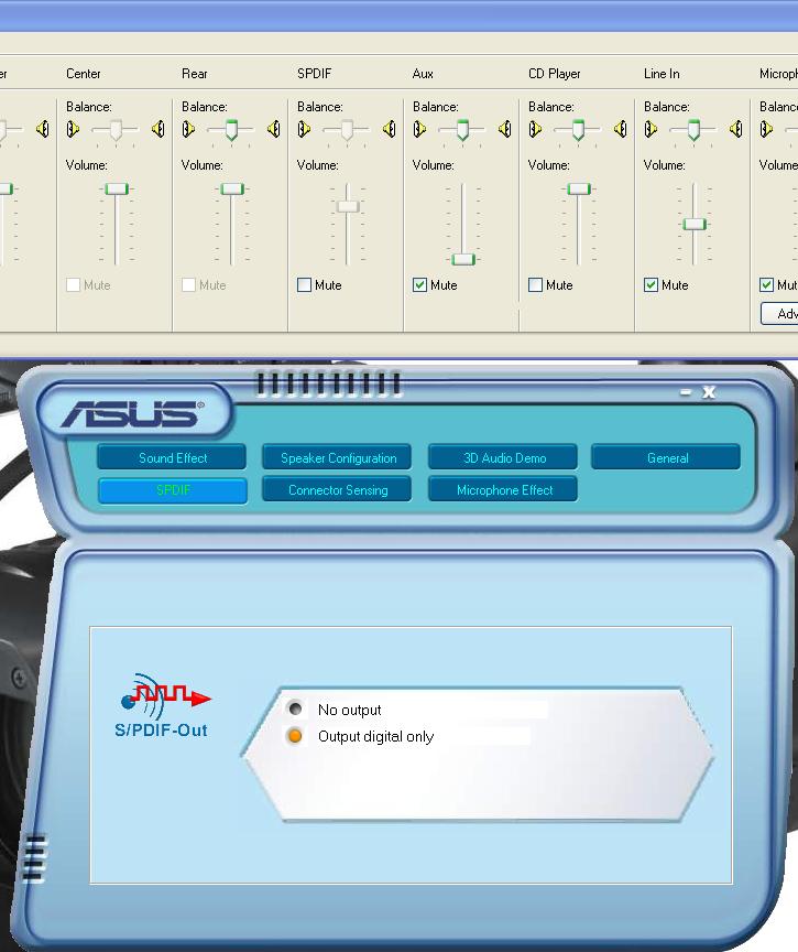

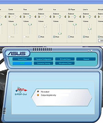

Old December 15th, 2007, 05:39 AM   #5
Location: Melbourne, AUSTRALIA
Posts: 735
Originally Posted by Jack Zhang View Post
Install a new driver from the ASUS site, hopefully it'll come with software to control the SPDIF output. If there's no software and only a driver, go into your volume control and there should be a advanced button under the master volume. Click it, and if something says SPDIF or digital speaker is unchecked, check it.
The driver seems to be up to date, and I've tried to fiddle with the SPDIF audio volume hundreds of times but guess what... every volume control I want is available but... sure enough, SPDIF is greyed out and unalterable. That said, the volume is at about 80% and is not muted.
Within the stupid ASUS software that came with the motherboard, SPDIF is enabled as well.
I am so over this... I wish it were simple...

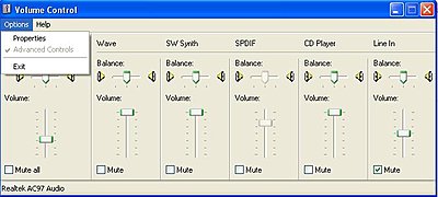

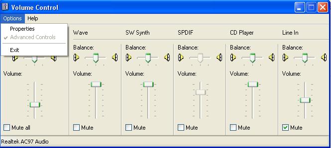

Old December 16th, 2007, 03:38 AM   #7
Posts: 735
Update/reinstall the driver again, if that doesn't work, uninstall your old soundcard's driver as it still lingers around.
Did that already. Even did a system restore back to before I installed the Audigy Sound Card.
For the SPDIF being greyed out, that's normal since Digital audio retain's it's original volume when output. (unless you change the master volume in 2 channel mode.)
Check in Volume control for the advanced button under the master volume. Please provide a screenshot of the "Advanced controls for volume control" window.
Well, since I updated the drivers, the "Advanced Controls" is also greyed out. I can't believe it.
