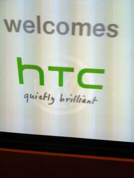

They are Panasonic TVs, which have client logos on them.
As you can see from the image, VW has been burned into the screen.
Any ideas on how to clear this?
-C

This happened to my computer a while ago. I ran JScreenFix for a while and it went away. I've also read that LCDs don't actually get "burn in," they get a persistent image. Evidently the persistent image just goes away after a while if it isn't too bad. I'd run JScreenFix whenever you aren't using the screen anyway, it can't hurt (except maybe your eyes.)

Yes, LCD's cannot get burned in. Turn off the LCD for a day or two and it should go away.
