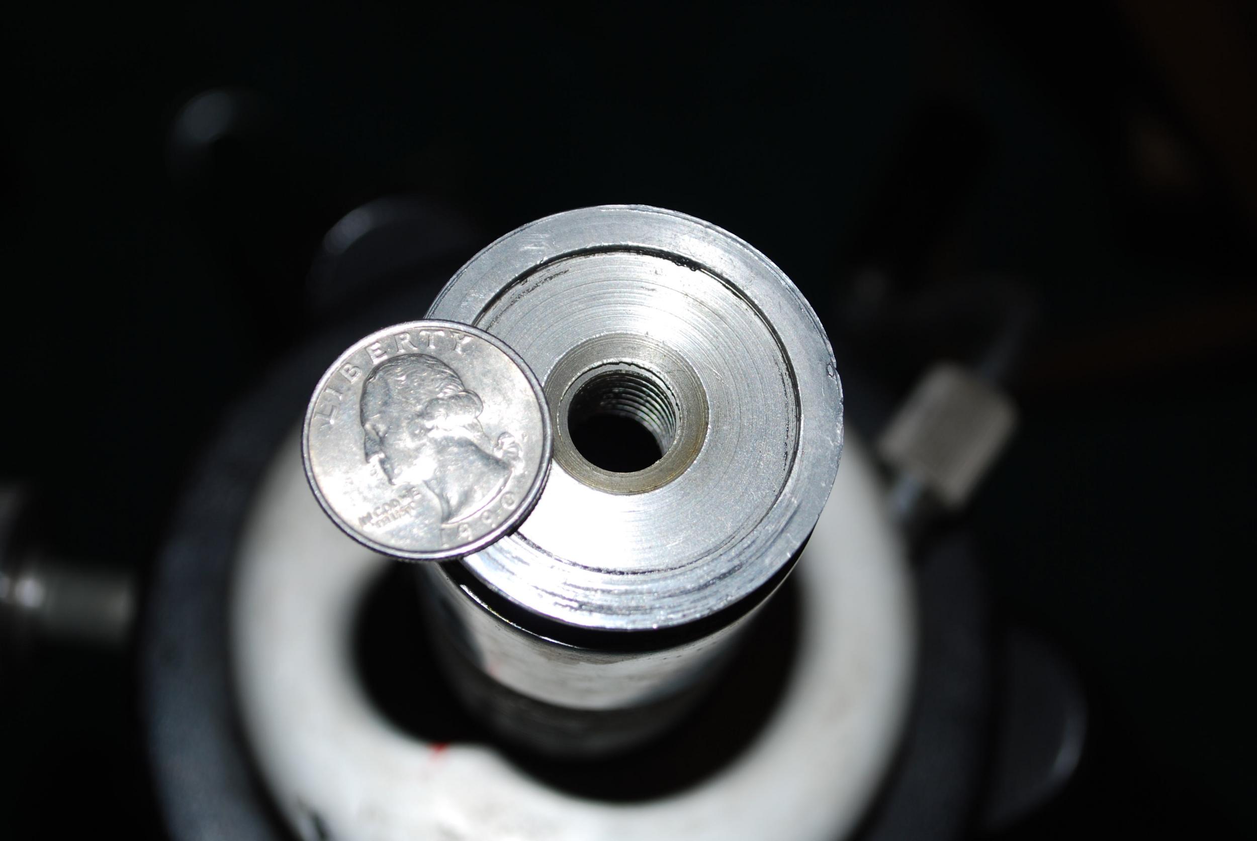

If the tripod doesn't have a bowl, then the connection from legs to head is usually a 3/8-16 bolt. If there's a bolt on the top of the legs you found, and it's too big to screw into the mounting hole on the bottom of your DVX100, then it's probably 3/8-16. If it does fit, then it's a 1/4-20. There are adapters for going from 1/4-20 to 3/8-16.

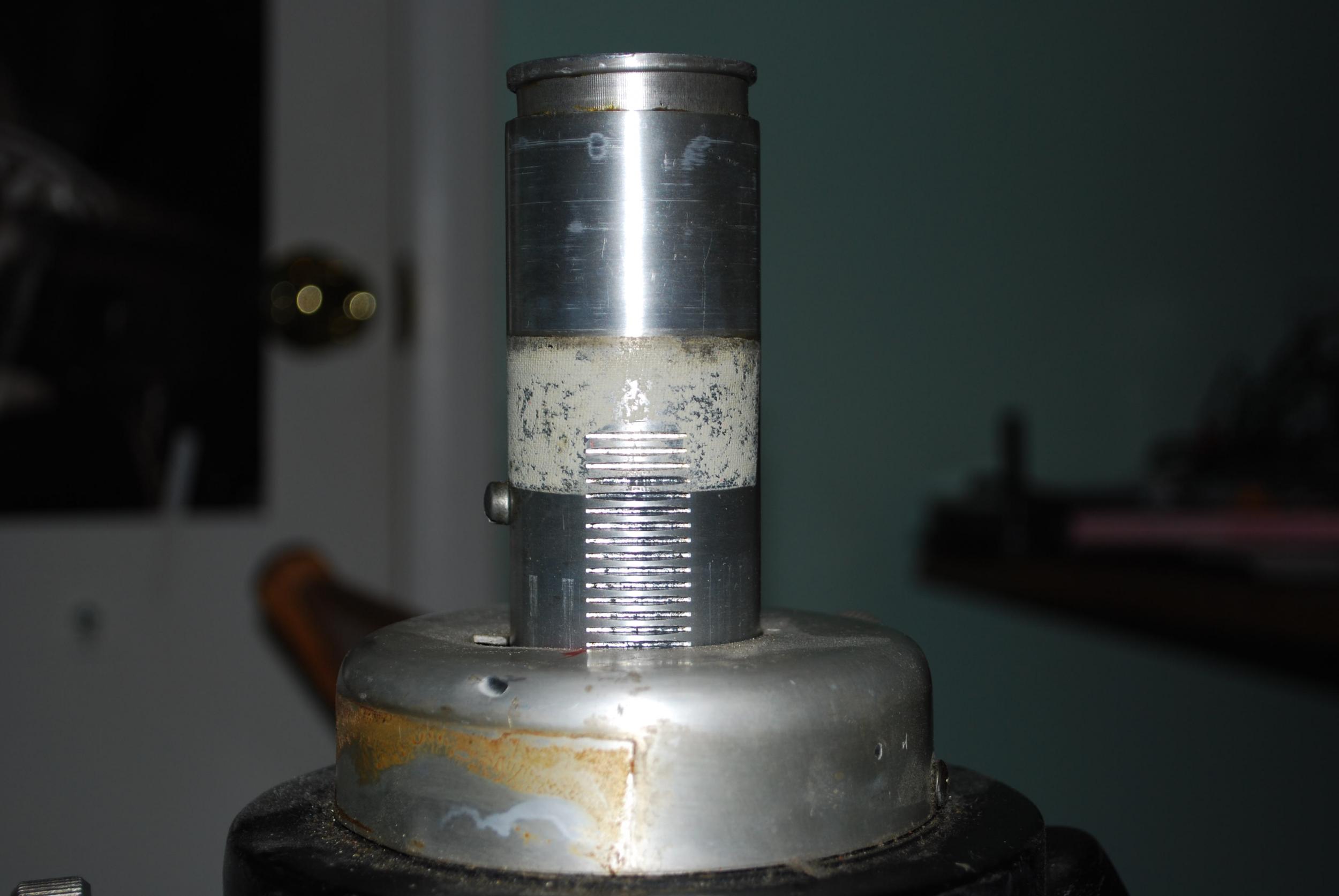

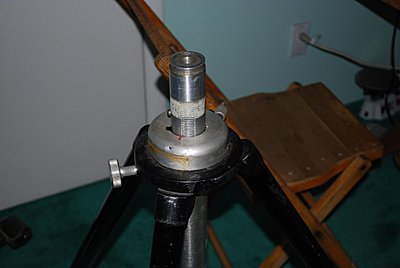

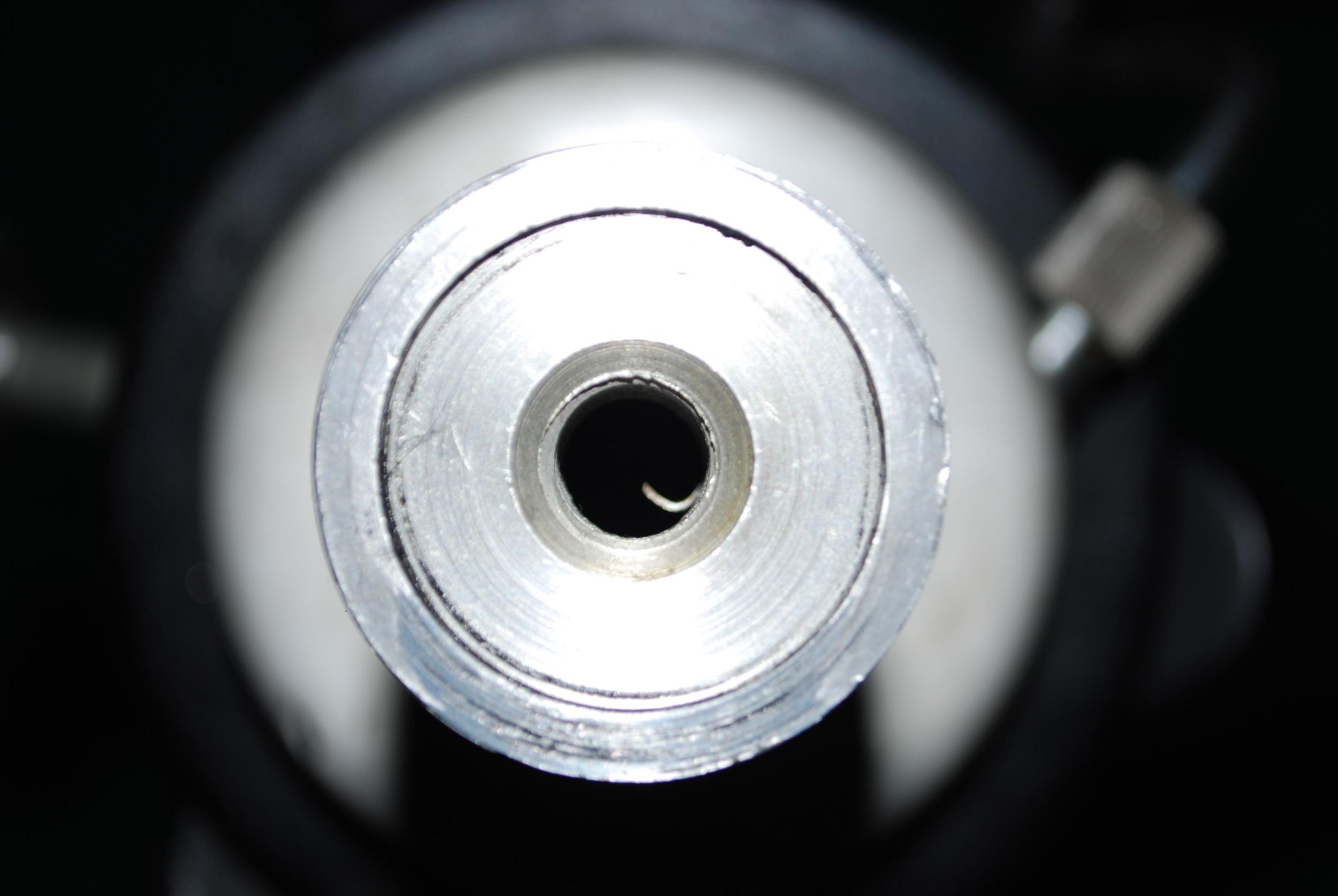

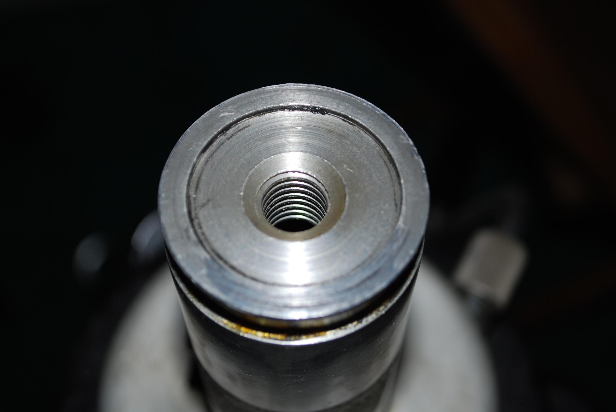

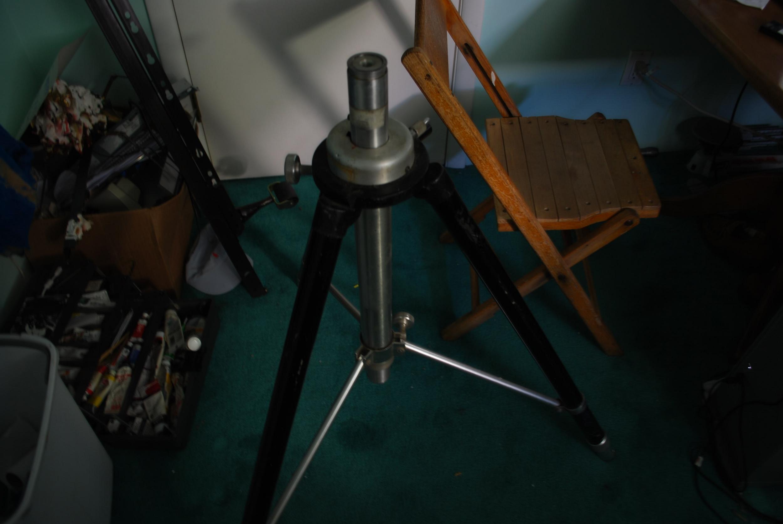

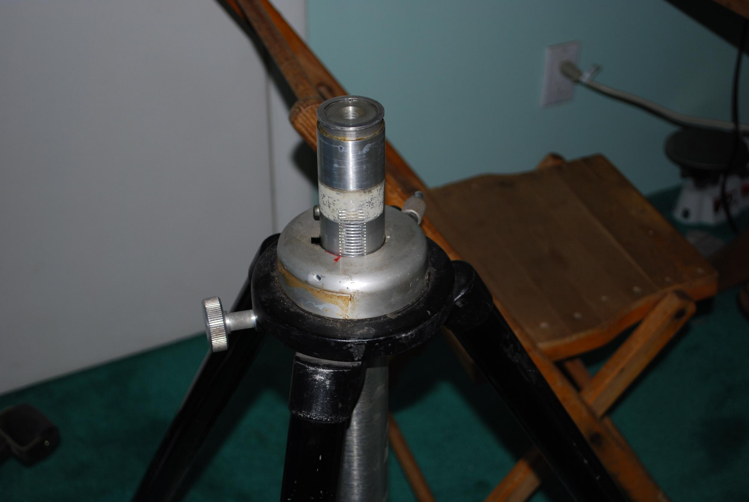

Here are some pics of the tripod, with a quarter for size reference. Thanks a lot for the help guys. So the part on the very top is considered the bowl? And the head kind of screws into the bowl? Am I understanding this correctly?

No what you have does not have a bowl. I don't even know if you can buy a head for that tripod. If you find a head for that tripod I have doubts that it will be smooth and allow for nice shots. However, since you found it in the garbage for free, its always worth a shot.

You might be able to fit a flat base head onto it, but looking at the pictures it seems to be studio type tripod for a large format stills camera. I suspect it would prove to be frustrating to work with, although it could be handy if you need a locked off second camera.
Having a handy means of levelling your camera makes life a lot easier.

Bazooka & Tulip bowl
Hi Anthony - there is something called a 'Bazooka' (in the U.K.) which is a series of tubes which stack on one another to give you a tripod with a very small 'footprint'. On top of this you put a 'Tulip Bowl' which, as you may guess, gives you the bowl (100mm) for your head. I would try to find a friendly Dolly Grip who might help you out. However, I have to say after all this, you may wish you had never found the thing in the fist place!

Anthony it looks a little like a tripod I own which is made for mounting a trapazoid binocular mount or a dovetail mount for a small telescope, not for cameras.

If the threads are good on it, you might be able to fit a Manfrotto 438 leveling base on top of it. Then your options of finding a good head will be easier.
No matter what a tripod is built for, as long as it can take the weight & doesn't move, you can put whatever you want on it.
It looks like a beast to move around, but could be a very great find.
