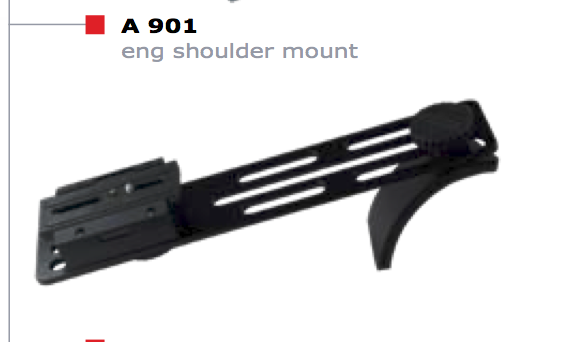

I can't tell if this uses the Focus plates or not. On page 32 of the 2009 catalogue:
http://www.cartoni.com/eng/Cartoni2009.pdf
Cartoni Focus Compatible Quick Release-screen-shot-2010-11-18-8.29.39-am.png

As far as I can tell...........
The shoulder support A901 appears to have a A 859 eng camera plate, but it could be a number of others depending on how they are configured.

I went down the Focus plate search, bail, then Manfrotto route. Only after going another route altogether did I run across the potential Cartoni product but didn't dig further.
I don't know if you've used the Manfrotto but I did and didn't care for it. In addition to being heavy, the release pin is on the right hand side which is slow, inconvenient and a bit of a pain. For the same elevation of the COG maybe a little less weight, I went the TA-100 route and am glad I did. The TA-100 does however require some engineering to mount the Canon XL specific camera plate to a non-Canon XL camera bottom. Westside A V sells modified TA-100's that go with their EX1 / EX3 plates. I put one Focus QR plate on a TA-100, another on my prompter and a second TA-100 on the camera mount of the prompter. A third TA-100 is on the shoulder rig.
