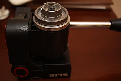

To quote someone else from this board: "Cause of death: Autopsy". Not sure whether I've ruined my Slik u212... I was able to screw part of it off, but I don't think I've got it right. When I was taking it off, I snapped part of the thread. Luckily, I can at least still screw the head back onto the tripod. Is anyone able to tell me where I've gone wrong?

As I said in my mail, I was looking for the link to one of these with the head removed, but it is eluding me so far, and I'm wondering if I just imagined it having read the spec's here:
Slik | U212 Tripod | 612-212 | B&H Photo Video
It definately says "Head Mount thread size". If it is correct then I can only assume the head has decided to dismantle somewhere else but the head mount, but what, I can't say as I cannot find a clear enough photo of one of those heads to know how it's constructed.
Maybe someone else with one in their possesion can offer some ideas, gotta be a few on this board as there seem to be millions of them out there.
