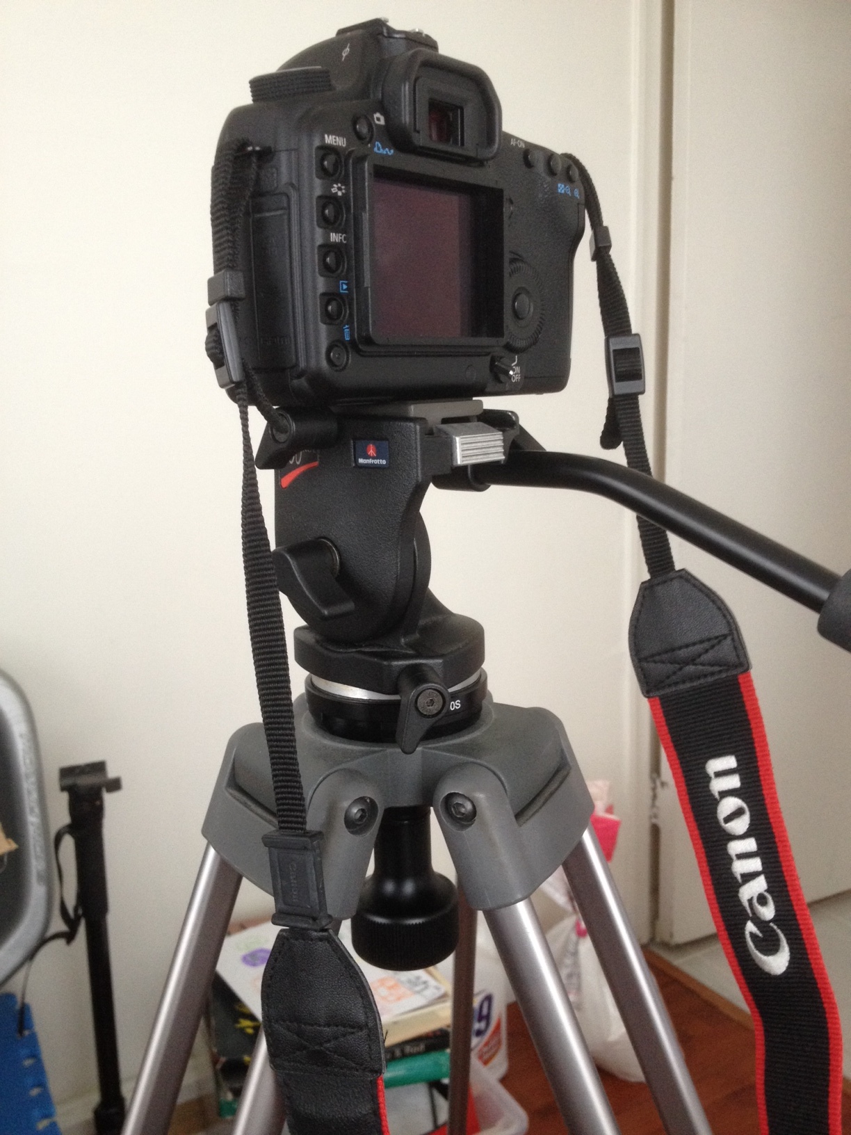

Sorry to dig up such an old thread--- but I found newly manufactured 65mm flat bowls on eBay that will fit the TH-M20 legs or any bowl tripod with the uncommon 65mm bowl size.
Pretty slick, now I have a choice of mounting better fluid heads in the future on the Libec.
