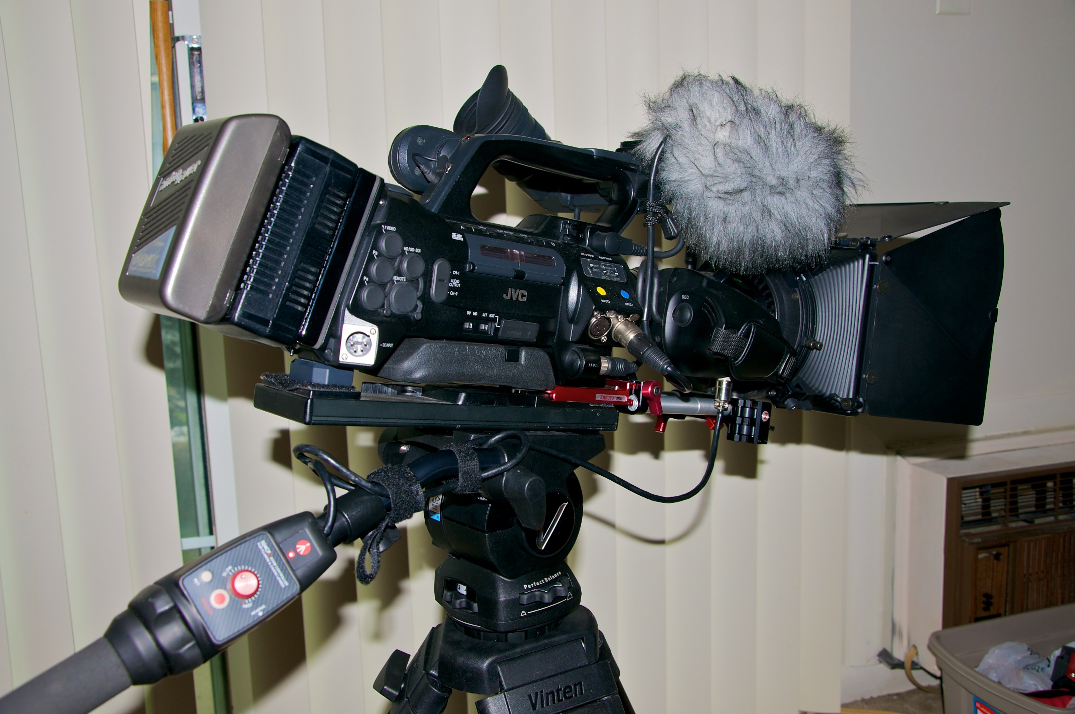

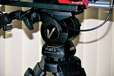

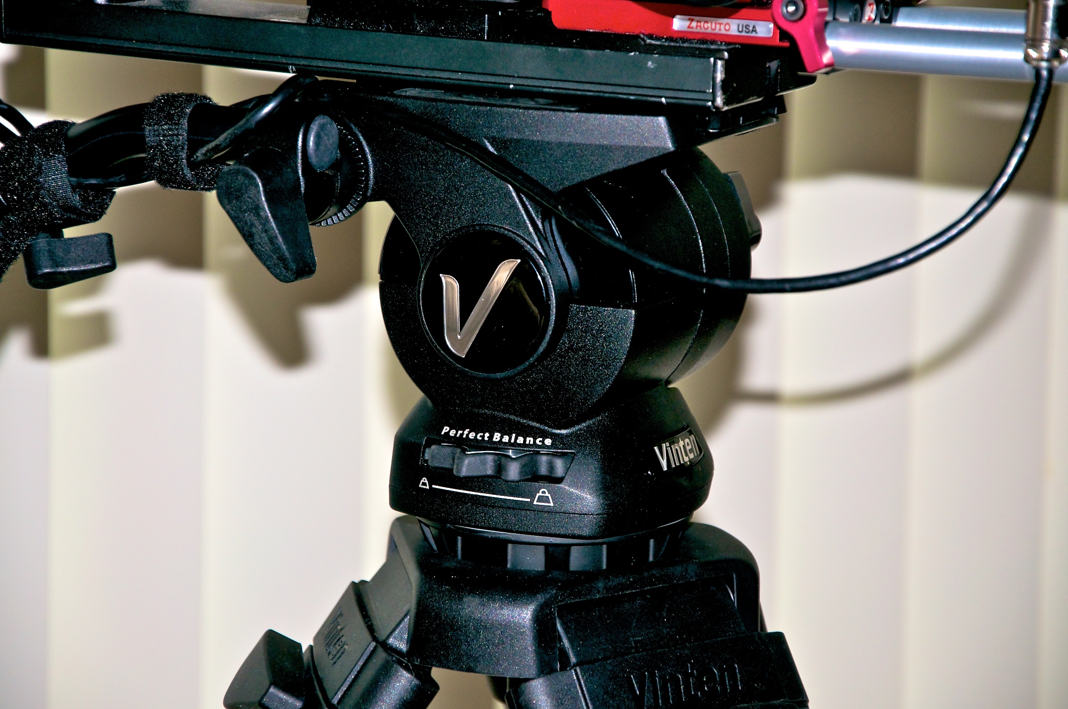

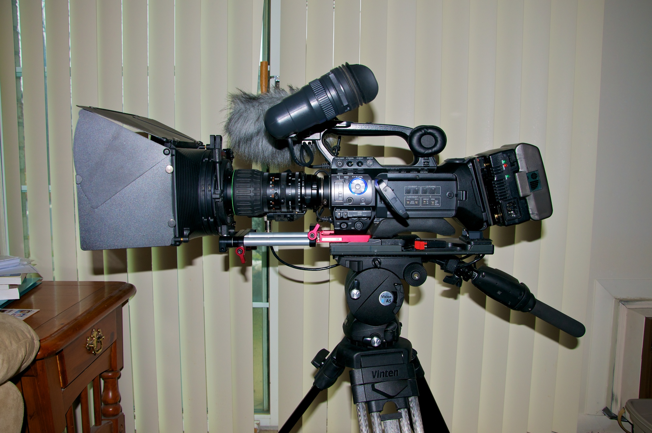

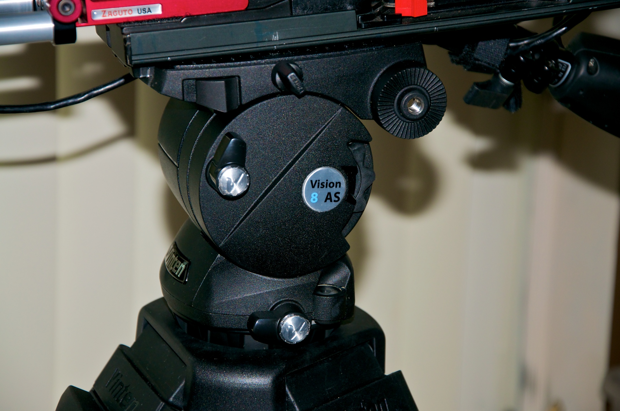

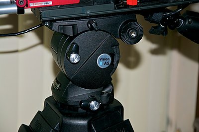

Many might ask what prompted me to pass up the very excellent 5AS, w/CF Sticks, & Mid level Spreader, and go up to the comparable 8AS CF/MLS system... $3,700 system up to a $4,700 system from B&H...
The bottom line is this, being a Civil Engineer by trade, I only trust specifications just so far. I have had instances where the specified abilities were overstated. I looked at the long term and the potential loading issues including balance problems using the charts as a guide.
I look at the bigger picture if you will. Expandability is the main reason. The current weight load falls well within the 5AS limits, but I did notice something when testing the 5AS with my system. The 5AS demo unit was very tough to balance for smooth stops even at the point I'm at in the build.... I needed to use the higher setting levels on the 5AS to achieve "Balance and Control". Many are not fully aware of how low profile, long, and lanky the JVC GY-HM700U is with accessories such as a large Matte-Box with two heavy 4x4 glass filters, not to mention another 6"+ out the back when you add the charger/AC unit and a HYTRON 140 which weighs 5.5 lbs, and beyond that, a Manfrotto Remote Control Pan handle. The end result is a cam coming in three feet (+) long from tip of french flag to the end of the remote control pan handle (Which can be telescoped).
Please understand, this is only what I have on board now. Add this in the future...
Zacuto Z-ZND-R Zound Rod Kit 15mm (About 1 lb.) Marshall 6.5 3G/HD/SDI Field Monitor. I also plan to do prime lenses in the future. I will be adding a Forward Focuser on the Zacuto Zephyr 700 bracket. 35 MM adapter. All this potential weight is going to be concentrated on the front end. I personally didn't think the 5AS would be the right choice for future expandability issues.
Again, as always I appreciate the help guiding me to the Vinten. I just happen to have the budget and the smarts to look long term. One Tripod... That's all I ever want to get... This was it...
Again, I appreciate all the help offered.
I only ask that potential future buyers consider the long term big picture. As a Civil Engineer I have a long standing rule...Always assume specifications are fudged by 10-15% on the plus side by the Mfg. and go from there. Maybe Vinten does not, but others do... Better to be safe in the long run. It's your money.
Steve Nordahl
Bethlehem, Pa.
