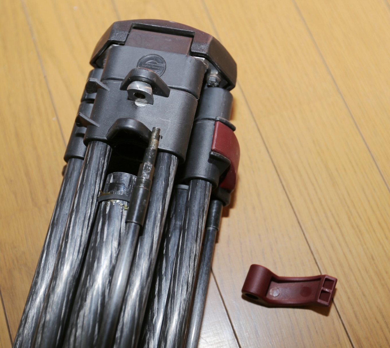

I got a pair of the 75 CF SpeedLock sticks with my FSB-6 fluid head. They came apart on me twice. The carbon fiber tube came out of the plastic base. It appeared to have minimal adhesive on it. I got it back together and used some 3M 5 minute epoxy to hold it. Worked for about 5 years then did it again. I just got it all back together this year, but only had super glue to hold it. I use them with just a Sony AX100 now, not the FS7. When that tube comes out, it also pulls the tightening rod out with it, which operates a cam-driven lock at each extension. Have to fiddle around a bit to get things aligned so both locks operate properly. It ruined a shot at golden hour on a pier in Hong Kong. The subsequent handheld footage is no good. And then trying to get it and my XL-H1A into the back seat of a taxi with the one tripod leg fully extended was no fun. I have not abused these legs. They stay in their padded case most of the time and have flown in checked baggage and have been left in the back of my SUV for anywhere from 2 days to 2 weeks, then back into the closet. My Gitzo series 3 CF legs have been around longer and I've never had a problem with them. I've taken them apart to check the leg locking parts for wear and tear and to clean everything one time when I had to set them up in a foot or so of sea water.
