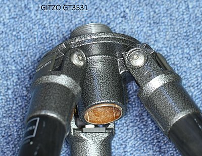

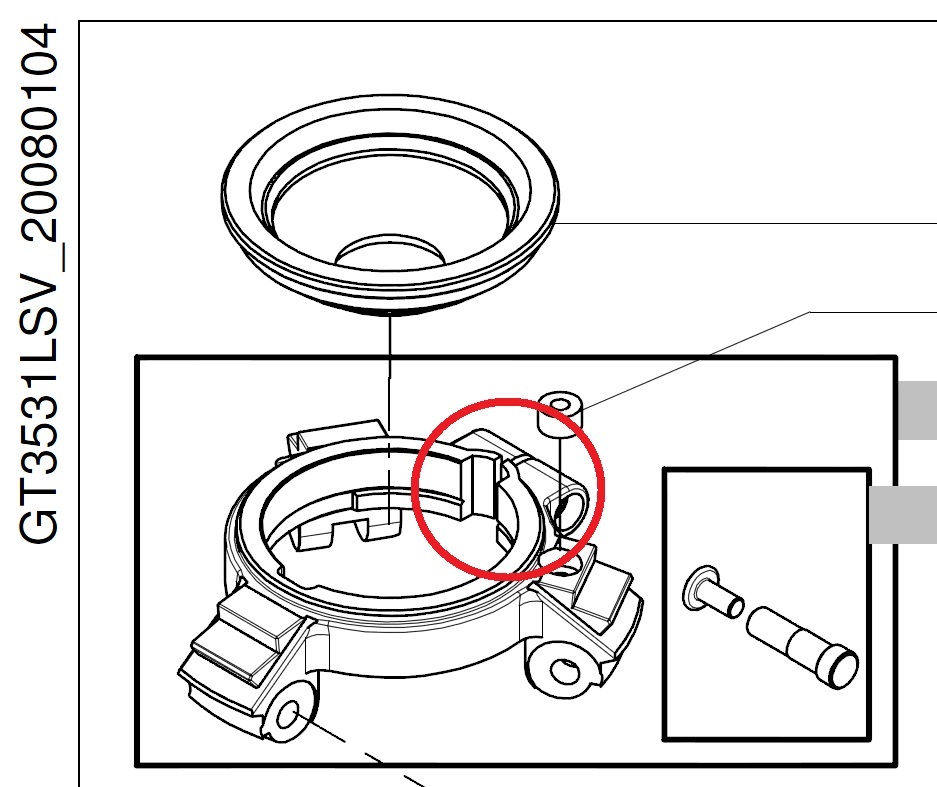

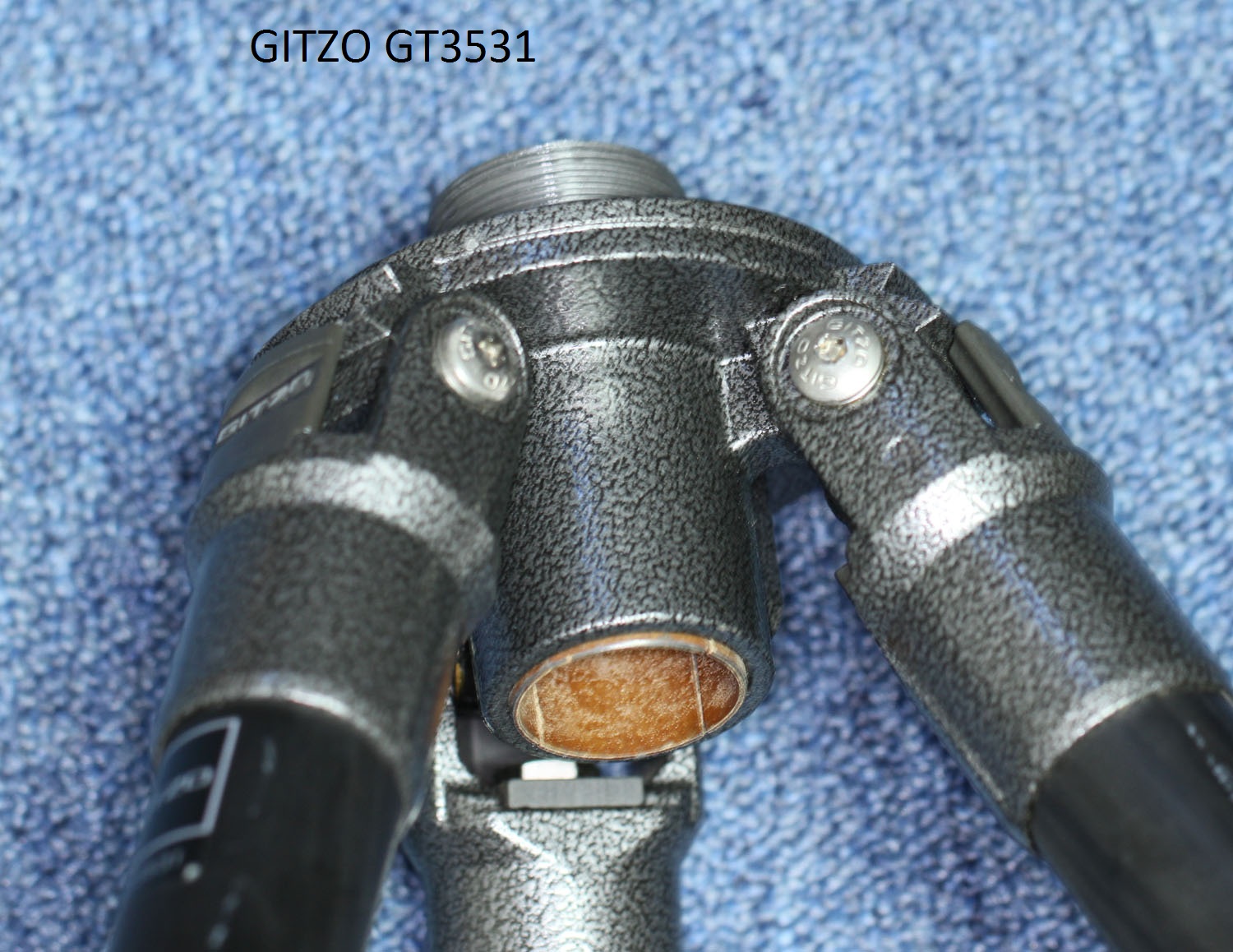

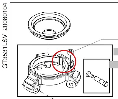

Les,
I have the GT3531 and it is not in the Systematic line, meaning it doesn't have the interchangeable head parts. The head is a fixed design with a rapid center column.
The GT3531S or GT3531LSV are in the Systematic line and you can configure them with either a center column, 75mm bowl or 100mm bowl. The folded length of a GT3531LSV is 26.4 inches, the GT3531S is 24 inches.
From the B&H description of the GT3531S: "Systematic tripods are supplied with a flat top plate. The optional support attachments can be fitted by simply unlocking the bolt in the top casting, lifting out the flat plate and fastening in the alternative adapter or column."
(The pic is of of the GT3531, the diagram is showing a GT3531LSV)
Mark

thx mark i stand corrected, looks even simpler than i thought with one bolt.
