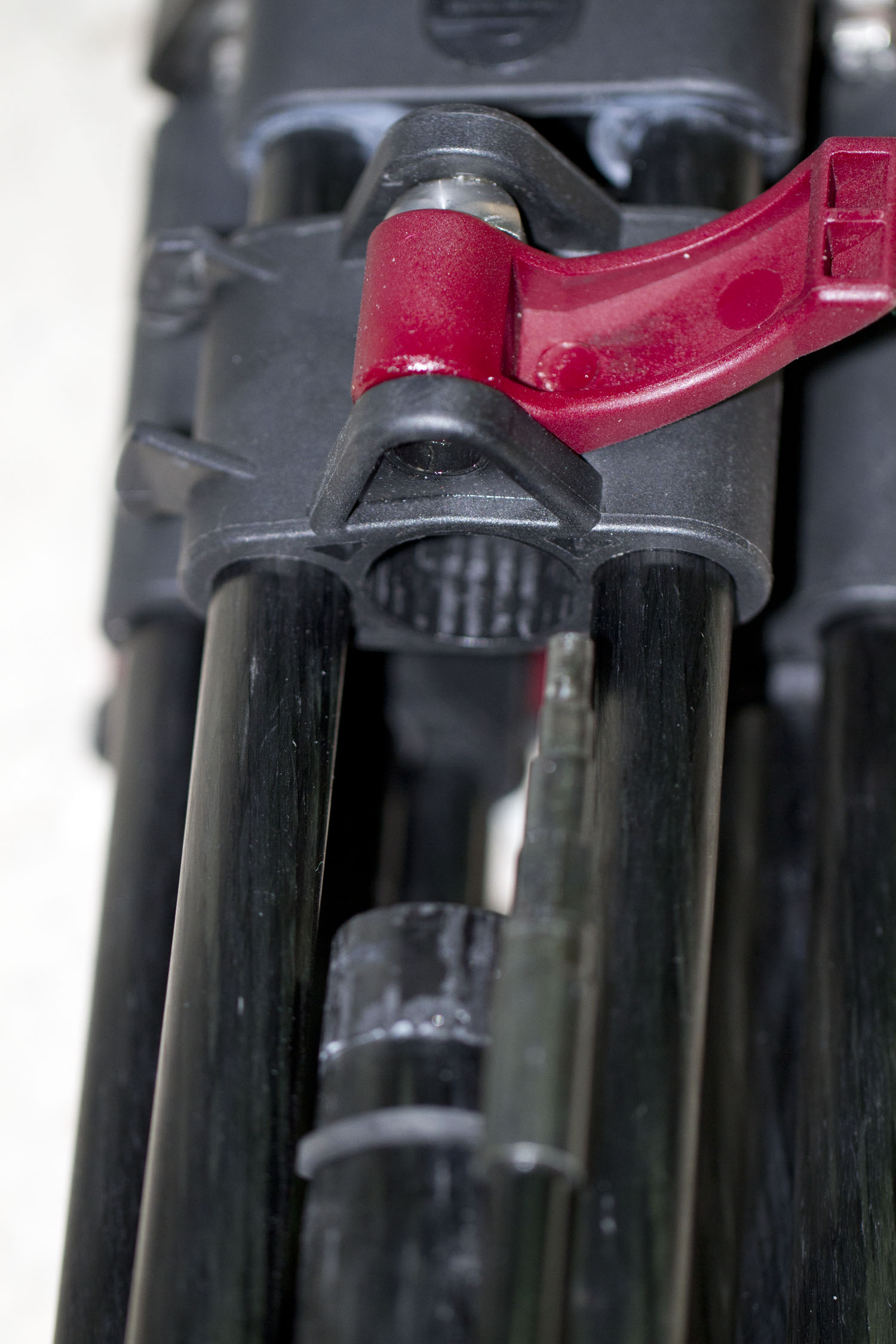

I have those same legs and had a breakdown a few months ago. I was extending the legs and one leg just came apart. The carbon-fiber tube came out of the plastic block, which allowed the metal shaft to come out of the latch. I got it back together and applied some 5 minute epoxy to hold the tube in. I've been wanting to replace this tripod with a set of Gitzo sticks for some time. Haven't been able to find a set in the shops I've visited in Hong Kong and Singapore and don't want to order anything until I'm sure it will be compatible with the FSB-6.
