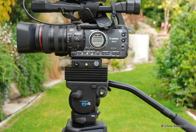

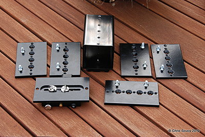

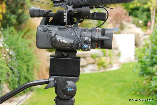

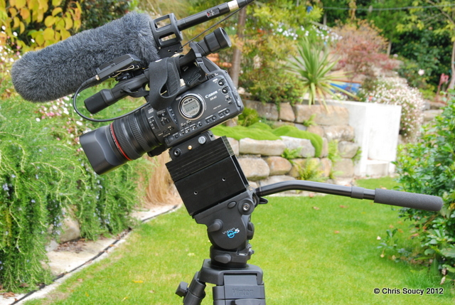

The CB100 is a totally configurable system allowing any camera to be mounted on pretty well any more powerfull head (and I stress, the CB [counterbalance] system on the head must be too powerfull for the weight/ centre of gravity of the camera in question).
It does this by using a combination of both weight and height increase, to fool the heads CB system into thinking it has "the real deal" on board.
In the case of the original Vision blue, for example, there are quite a few cameras out there just slightly too light or too low a COG to work with the CB system.
Using the CB100, you can (slightly, grossly or anything in between) bump up both the weight and the height in an incredibly short time, mere minutes, and use even the dinkiest camera, just like the big boys, and the Vision blue (or any other head) will behave like a dream.
With an adapter of your choice (we're using the Manfrotto 577), you can detach the camera from the CB100 in a flash, then detach the CB100 from the head ditto.
That's why it's headed for NAB, Peter was interested to see it in action.
I needed it for my review, as my Canon XH A1 weighs in at about 7lbs, reasonably pimped.
The COG of the Canon was probably about 4" or 100mm at a guess, so not a snowballs chance it was going to work, and it sure didn't.
The Vision blue5 has a CB range from 12.1 to 26.5lbs or 5.5kg to 12kg @ 100mm COG.
Sooo, the CB100 went into "grossed out" mode, which it can do without breaking a sweat, took about 3 minutes to configure.
I've attached a few pictures of three combinations that worked a treat, none of which I'd expect "most" people would ever need adopt, as their cameras wouldn't be that far out of the "sweet zone" for a particular head.
The CB100 is capable of far more subtle configurations than the ones in the photos, believe me.
Bear in mind, the unit shown is one of the very first, hand made units with no livery whatsoever, so a bit rough around the edges, and there are bits missing.
The "real deal" will be CNC'd and look the bees knees.
And no, we wouldn't expect most people to either want or need everything on display in the photo's, just what they need to solve their particular problem.
