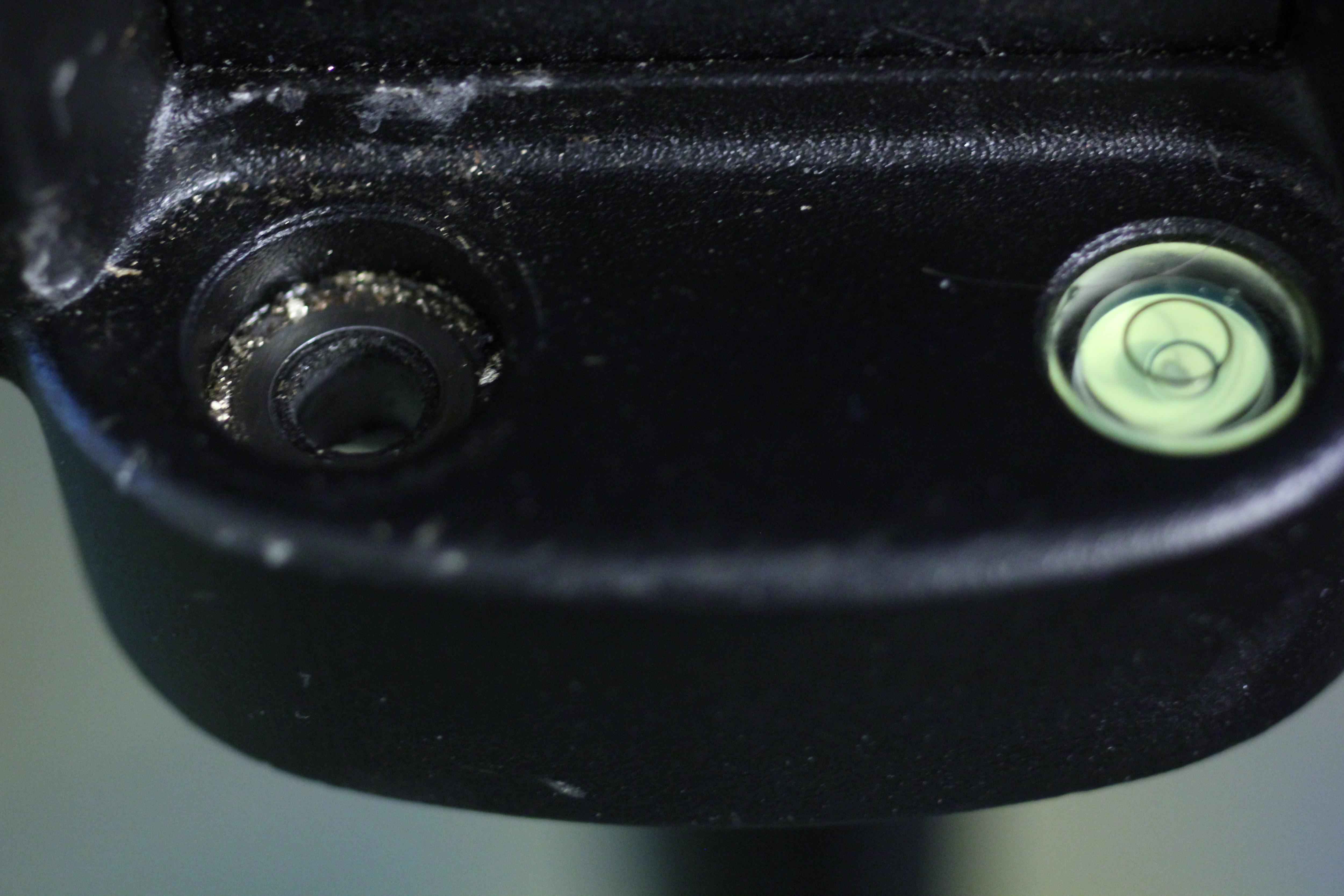

I want to see pics of what Victors pan break lever/mechanism looks like. It sounds like it might be broken or in some disrepair right now so with some pics we might be able to figure out the proper fix for it. I have a 501hdv sitting on top of one of my tripods and had a 501 that I used for many years so I'm kinda familiar with it.

not that bad right?

Wow...While the 501 series of heads may not be the top of the heap for fluidity, they are pretty tough. You have seemed to bring this one to it's limits and beyond. No offense meant but what did you tighten it down with? A small sledge hammer? From now on, not quite so much force on the parts OK!? Now on to the fix.
Do you have all the parts? The lever, the screw and anything else that may have popped? If yes then simply re-assemble. If no, tell me what parts you're missing or are broken.
