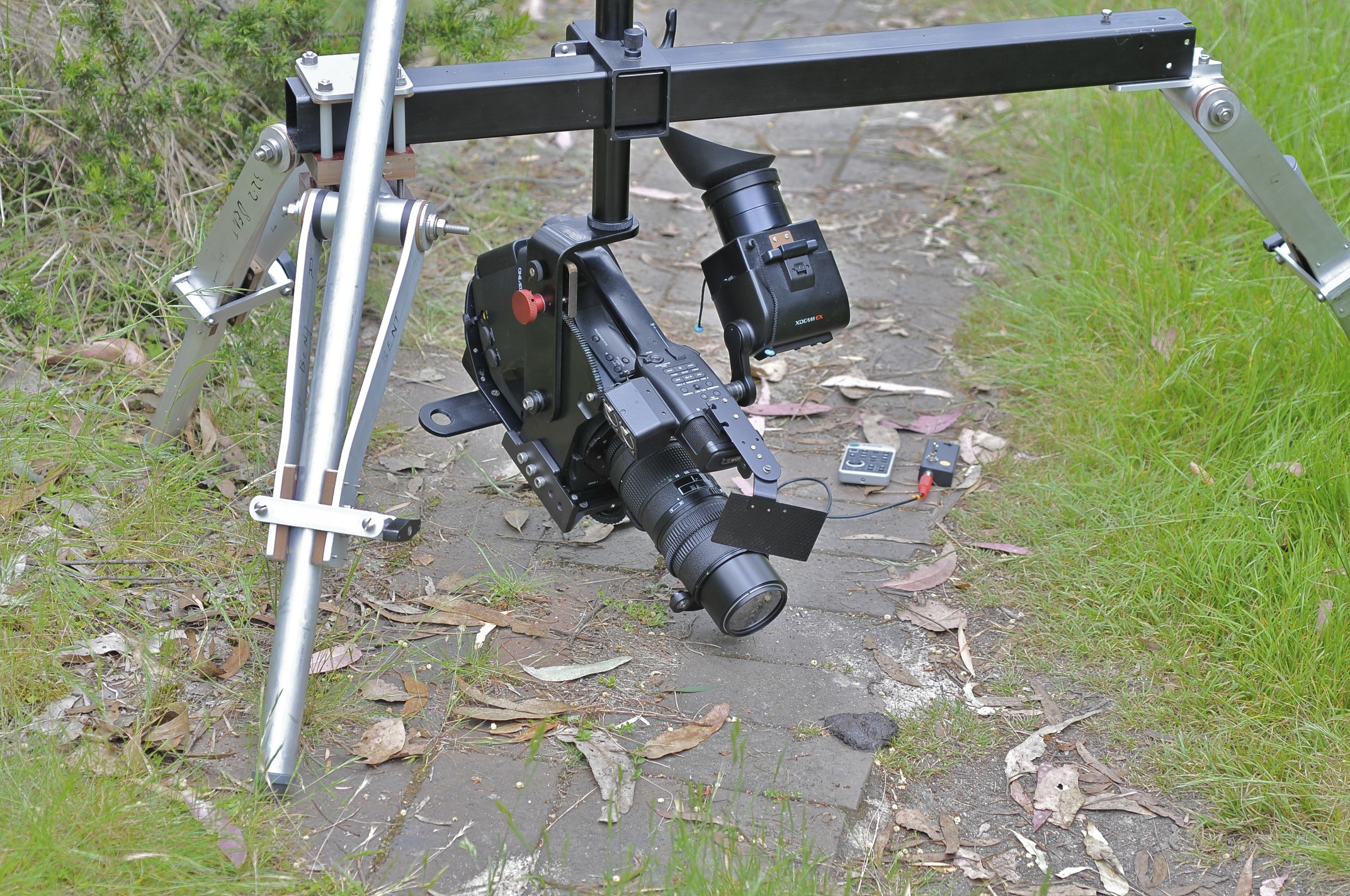

I am developing a tripod for low level work that may provide some ideas. At this stage it is essentially a ‘standard’ tripod that has the bowl replaced by a length of tubing or if you prefer a length of tubing with two legs at one end and one leg at the other. The picture shows an EX3 suspended from the horizontal tube. I normally use a lighter camera on a nodal head. In this case the subject is a fresh wallaby dropping. As the system works well I am adding a few improvements to better accommodate the heavier camera.
The idea has a lot of potential, the horizontal tube can be longer or shorter and can easily be changed. The next version will have two parallel tubes to carry a bowl carriage.
If any one is interested in trying something similar there are a few things to watch out for, firstly the hinges that permit the legs to swing in or out to adjust the spread need a tightening mechanism because the weight of the camera is not necessarily shared equally by the three legs. Secondly if you want it to fold up for storage/transport etc there needs to be an extra hinge point to permit the two legs to align with the horizontal tube.
http://www.dvinfo.net/forum/attachme...1&d=1359113609
