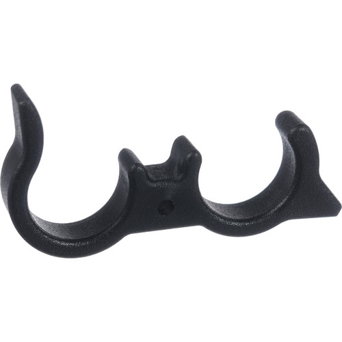

When I need to stay mobile I like carrying my tripod by itself with a strap. When my Sachtler Speed Locks were new this worked well, but with a couple years of medium to heavy usage, the legs are looser and like to spread out when slung over a shoulder. Does anyone know of a clip or "leg hook" that fits this tripod? The attached pic is of a part meant for Manfrottos 545s--something like this would work if I could find it in the right size.

You're obviously missing a vital component for those 75 CF's.
They should have been delivered with a double ended Velcro strap, one end of which fits around one of the lock lever rods (the ones linking the top and bottom lock mechanisms), thus tethering the strap to a leg, the rest of the strap then being wound around the base of all three legs and clipping to itself.
This prevents the legs from splaying during transport.
The easiest way to source this missing component is to fire a mail to:
Barbara.Jaumann@VitecGroup.com
giving the sticks serial number (on a label on the top inside face of one of the legs, right on the leg hinge pin line - you'll probably need to remove the head to get a good squizz at it) and your contact details, and request said part.
That said, she's pretty on the ball and may well read this before hand, so don't be surprised if she chimes up here on DVinfo.
I think I can pretty well guarantee that the Manfrotto part you mentioned wouldn't fit the Sachtler tubes, as the 75 CF's outer legs are slightly less than 16 mm, most of the Manfrottos are up around 18 mm from memory.

That sounds like what I'm looking for--thanks Chris! I just emailed Barbara.
I did buy the sticks new, but I'll bet I threw out the velcro strap by accident along with the packaging. I've seen the retractible cord with a hook type (on vintens) and the leg to leg hook type (like the pic I posted) but not a velcro solution. Hopefully it works for me.
