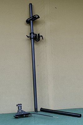

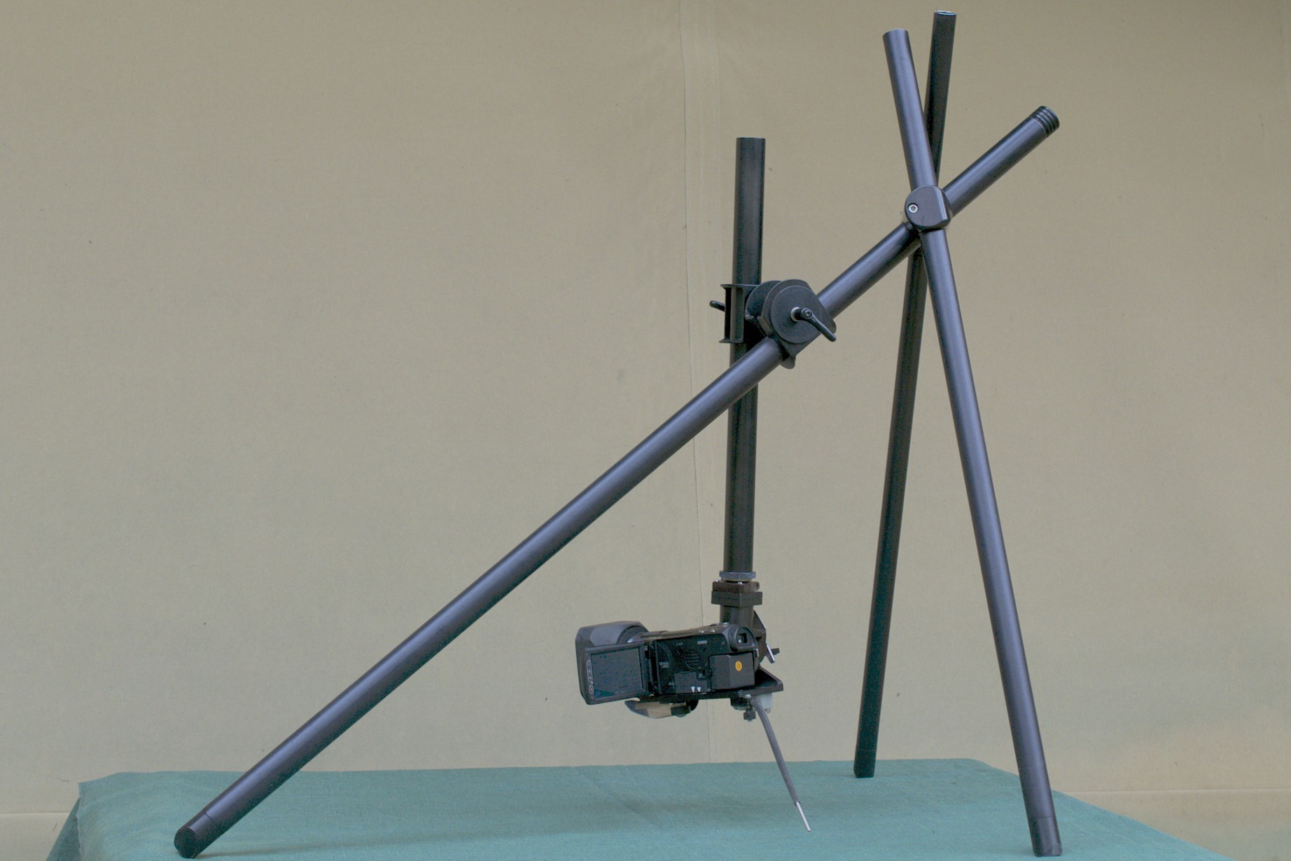

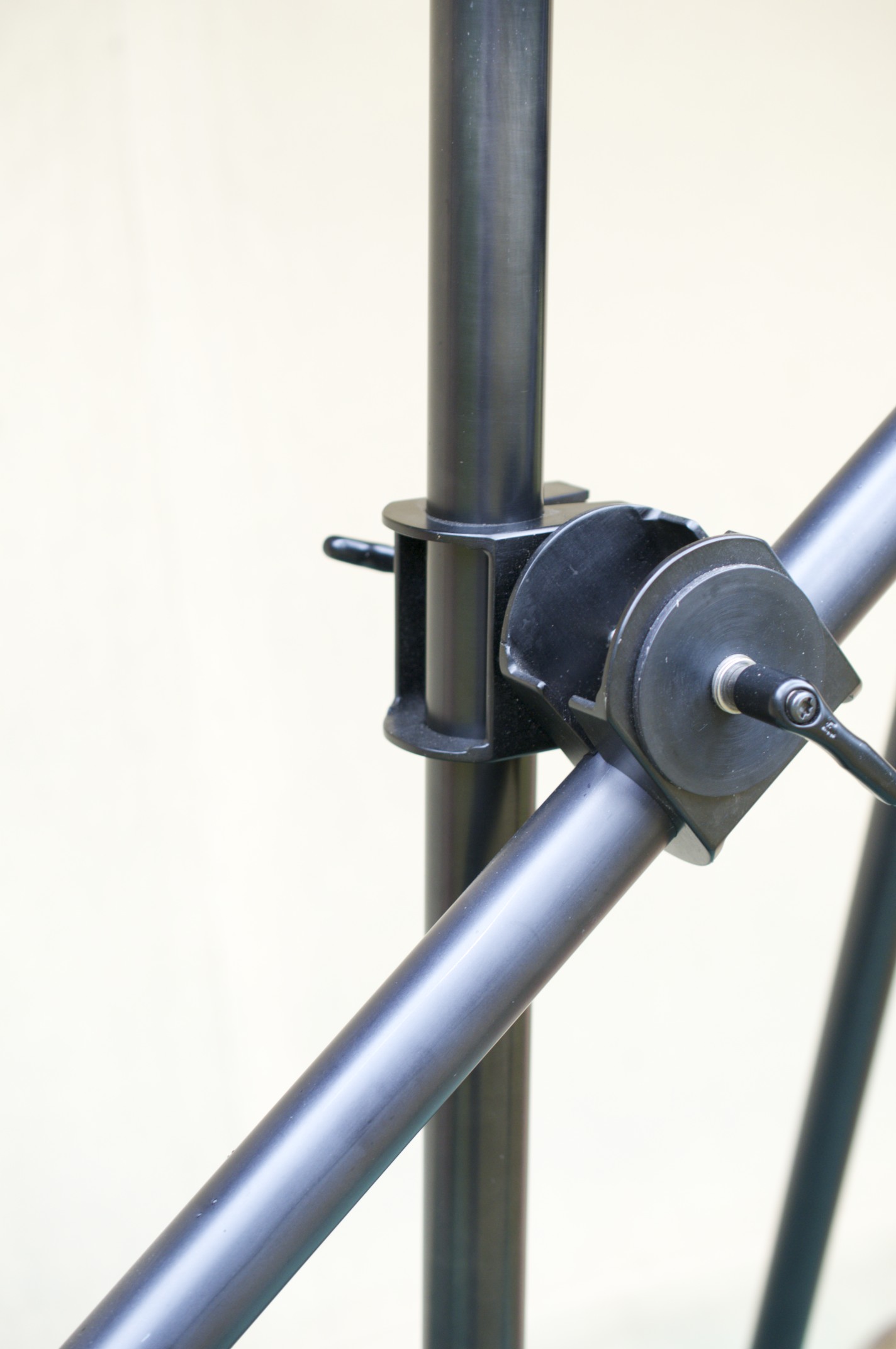

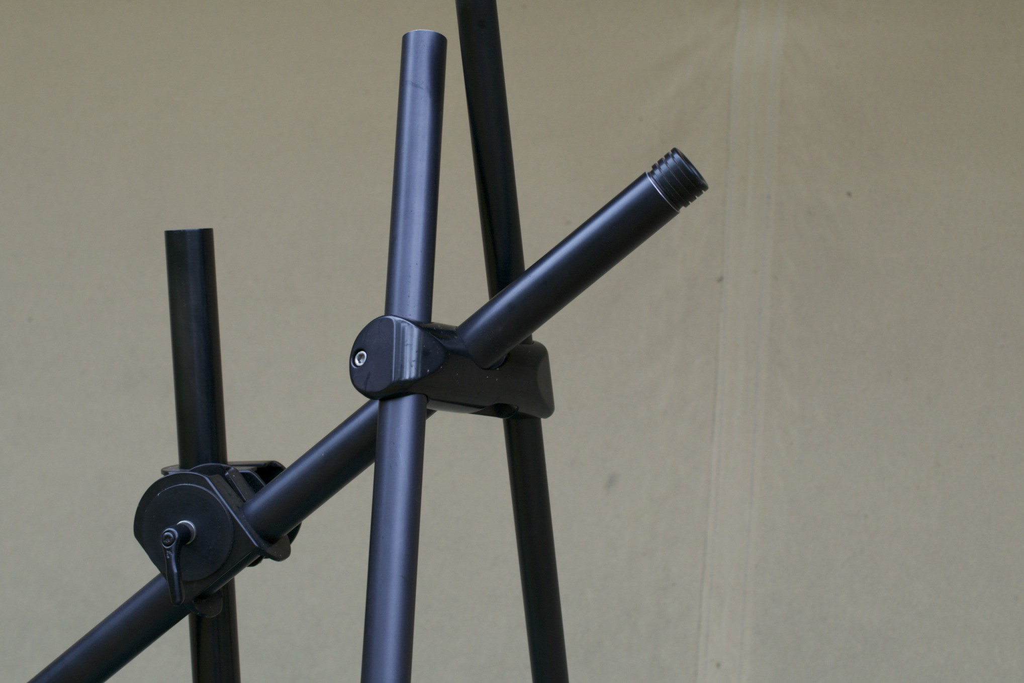

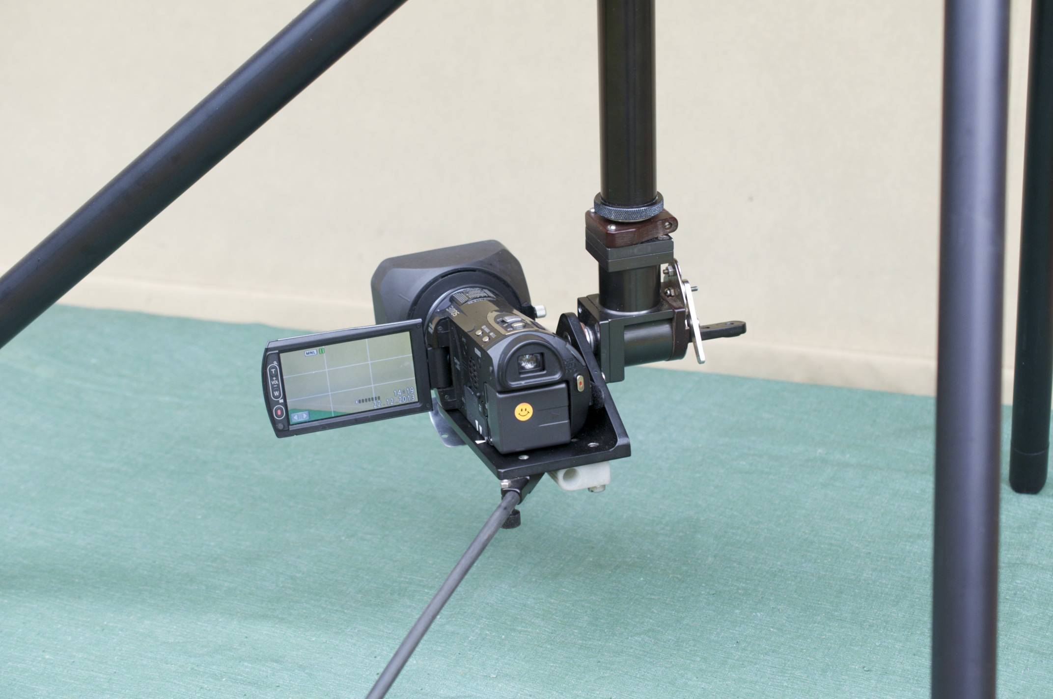

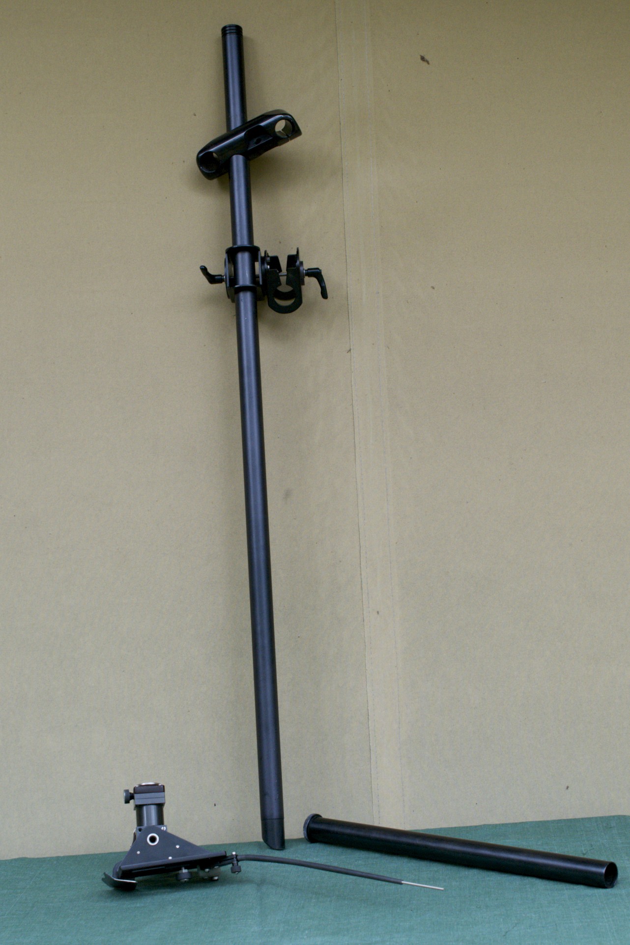

Hi Michael,
Here are some pictures of TraillPod Mark 3 that I described in an earlier post. It is set-up in low mode. Total weight including TM 900 is ~ 3.6 kg. Each leg has a fixed length for both stiffness and simplicity. The angles that the legs make to one another are fixed but height can be adjusted by repositioning the clamp block. As mentioned the legs have different diameters and telescope one into the other forming a ‘staff’. The last picture shows the set-up partly dismantled. Everything can be removed.
http://www.dvinfo.net/forum/images/a...1&d=1387690130
Good Lightweight Tripod System-_dsc9612.jpg   Good Lightweight Tripod System-_dsc9613.jpg
Good Lightweight Tripod System-_dsc9614.jpg   Good Lightweight Tripod System-_dsc9615.jpg
Nicely made setup. Good to see someone else who likes making their own accessories.
