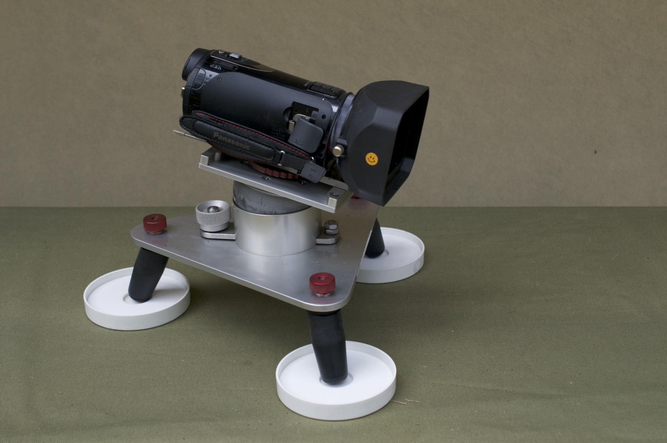

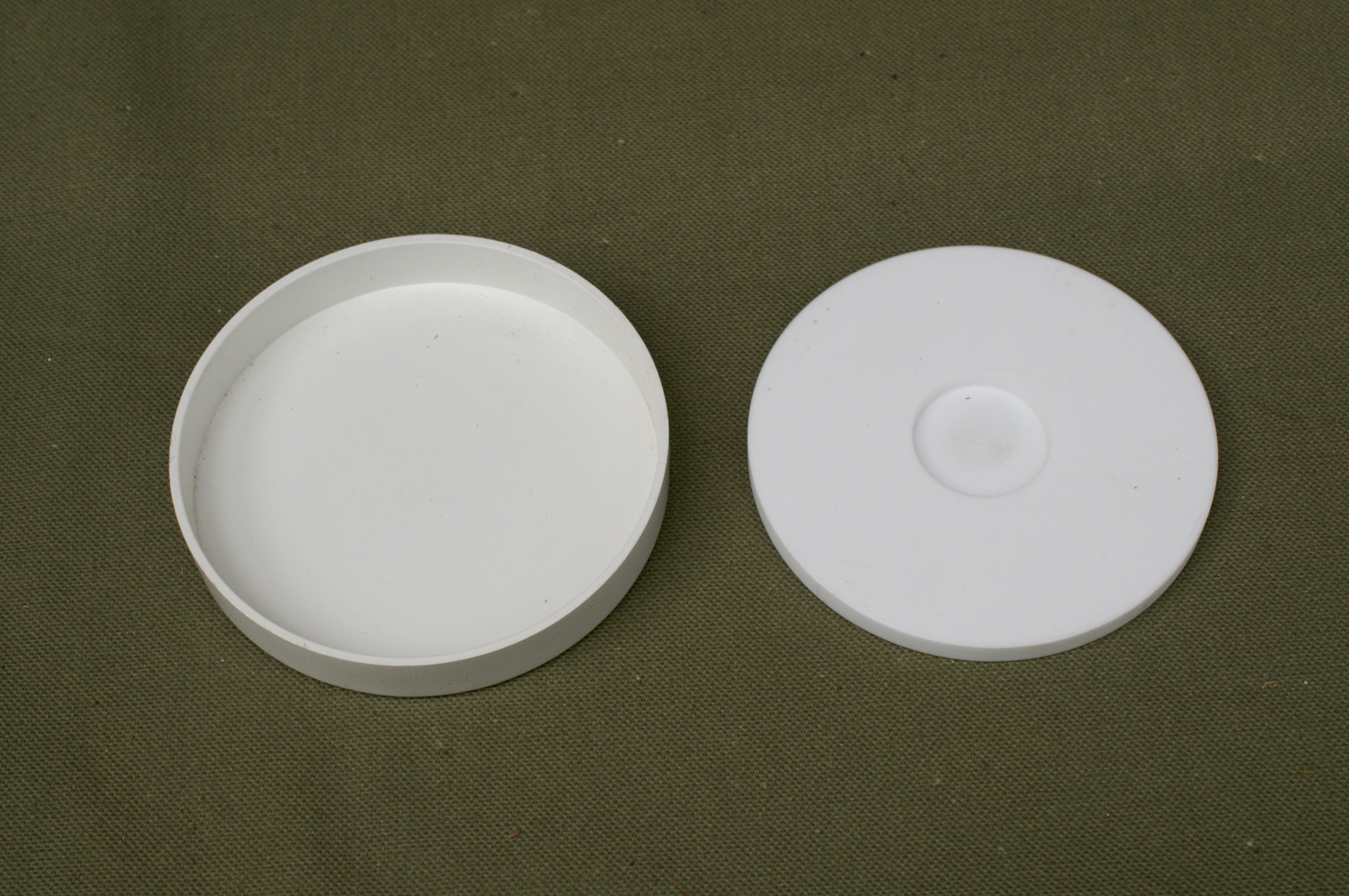

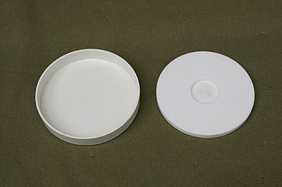

Hi Zelle,
You may find plumbers end caps to be useful. They are cheap and robust and come in range of sizes. I sometimes use them under a very low tripod for a different reason. When using a close up lens the focus range is very much reduced (maybe an inch or two) and if I set the tripod legs on the caps I can slide the camera easily and get into the focus range. However if the sand is very soft I fit an insert to the cap that has a recess in the centre that stops the camera from sliding.

I particularly like the 'Tennis Ball' idea and I will probably go out and see how it works. The more 'elegant' fix of the PVC End-Caps is also very interesting and I like the idea of being able to 'slide' on rugs or other material, rather than having to pick-up and move.
