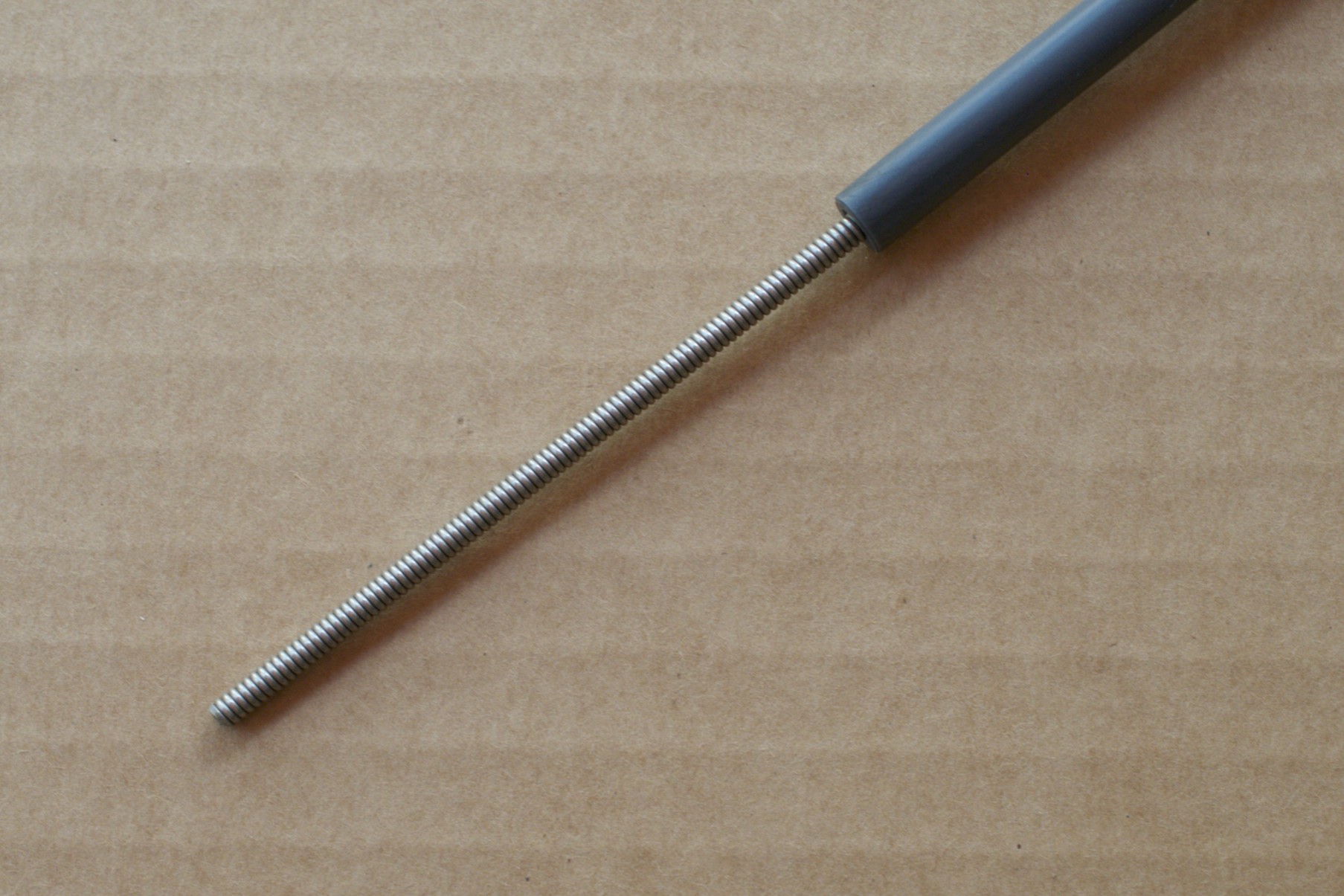

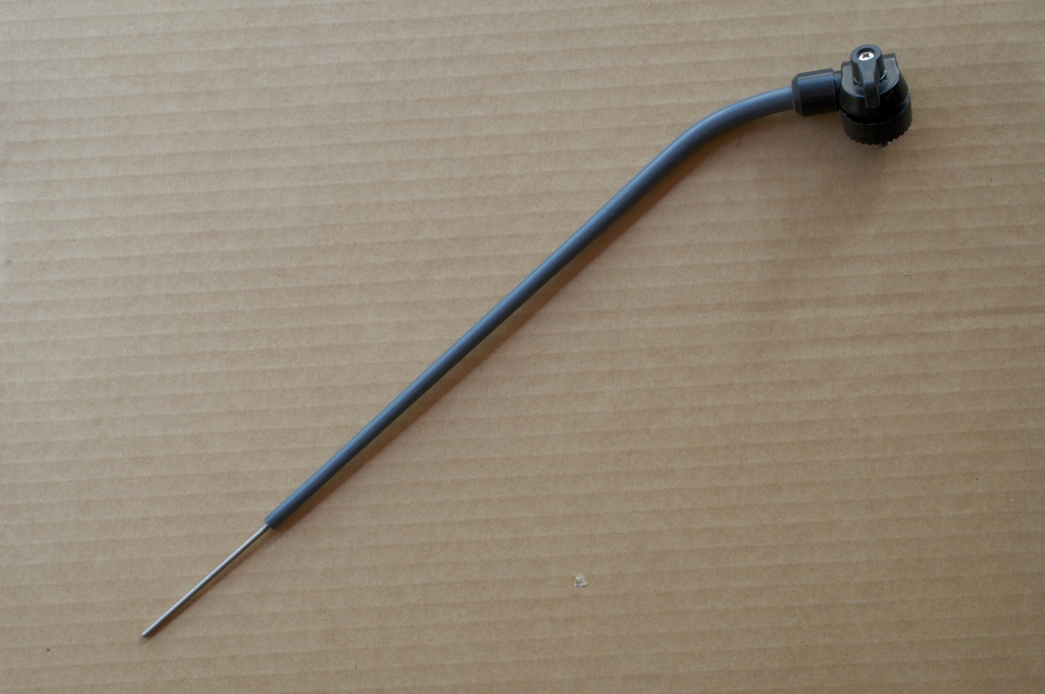

There are sure to be better tripod systems to try, however I am a great believer in having some flexibility in the pan handle, as it is the handle that is conducting the vibrations caused by your heartbeat etc to your tripod set-up. A simple experiment you can try is to loop a rubber band around the pan-handle and then pull on the rubber band to pan and/or tilt. Better results are to be had if the rubber is stretched to about half the stretch it is capable of.
I use tapered plastic handles that have a spring at the operator’s end. For very slow movements with a long lens I use the tip of the spring, for faster movements I use a point nearer the camera.

I have tried a VB and found it to be unsatisfactory with a long lens and slow pans. Like the springs on a car the flexible handle or rubber band is very good at reducing vibrations. Try one sometime.
