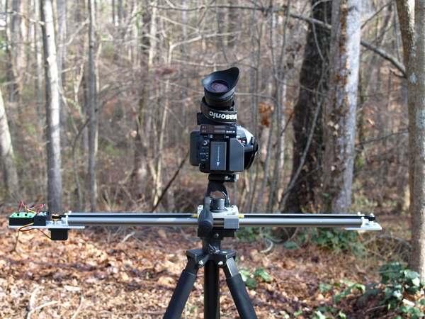

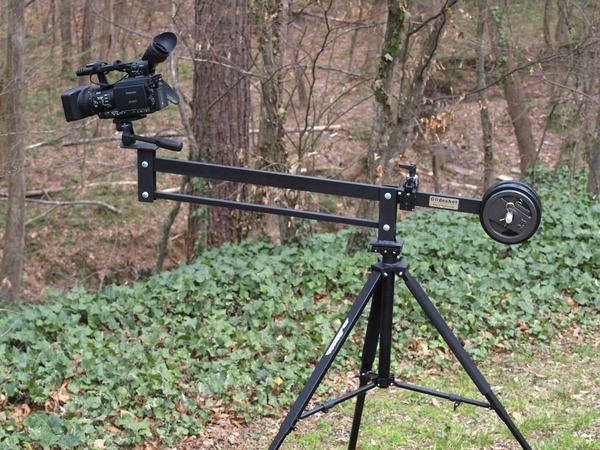

You need a second heavy duty tripod for the slider. It need not be expensive. Here is a write up I did on the Davis & Sanford ATP.
"I got this tripod to support a small 4 foot jib/crane and slider on hiking excursions. I selected it because of price and ability to support 35 pounds. My camera, jib and counter weights come to about 26 pounds. The ATP seems to hold the weight very well. With this type heavy setup I am always checking fastener tightness, because a tripod leg slip could spell disaster. So far so good. I did have a nut come loose on the spreader. I think I will replace the spreader flat washers with locking washers or locking nuts. Oh, in case someone is looking at this tripod to support a jib, I got a Feisol panning base mounted between the tripod top and my manfrotto quick release. The jib base then mounts to the quick release for easy setup and breakdown."
