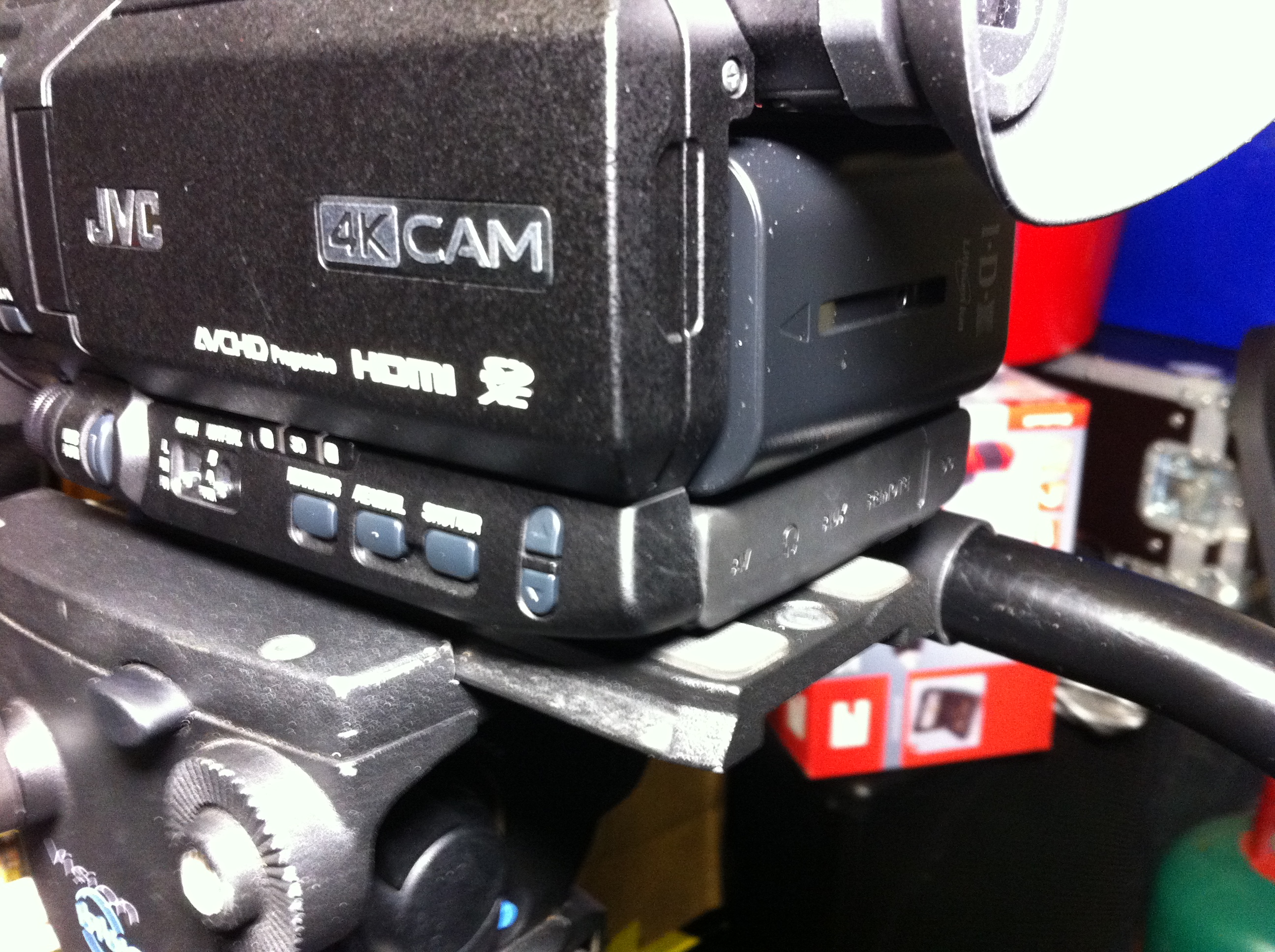

Hiya Folks. I'm using my new JVC camera on my old Vinten Blue tripod.
The standard baseplate supplied with the tripod, which is the same as my Vinten Pro Touch 10, is a little too long for the camera and it protrudes out the back (see picture).
The locating pin hole and 1/4 inch thread have been placed a long way forward on this camera, which makes it really front heavy as well. I've been looking online at offset plates of various designs. I don't want to move the COG too high either so if anyone has any recommendations please pass them on.

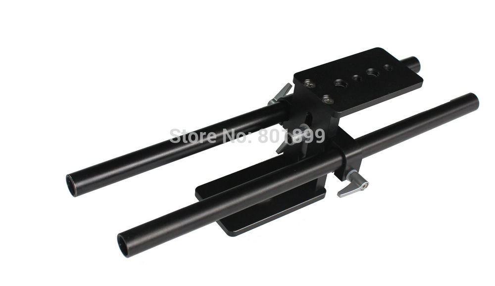

This is a nice little adaptor for Manfrotto heads, not sure if it would fit Vinten though: http://4dslr.com/4dslr/Product/10
