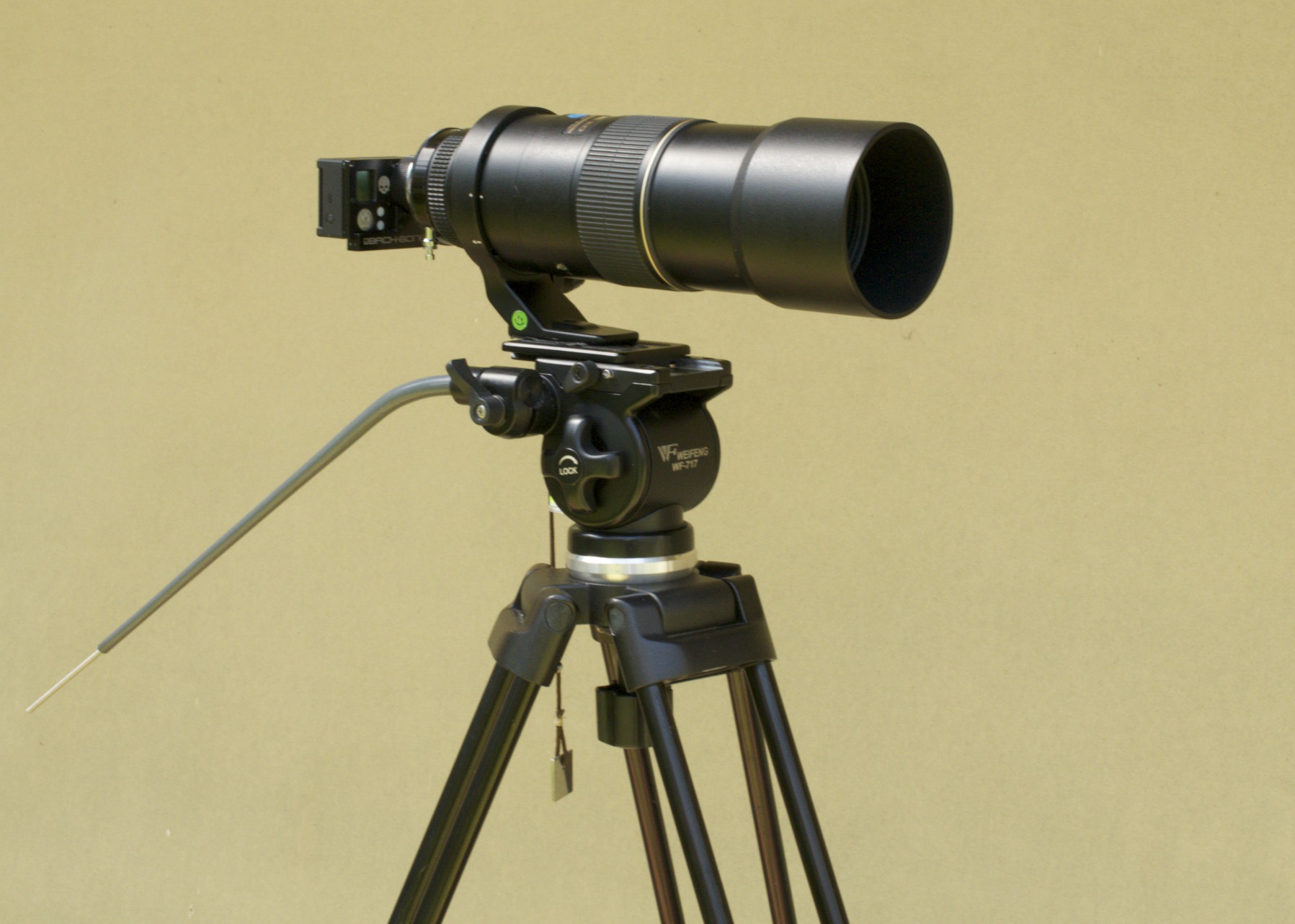

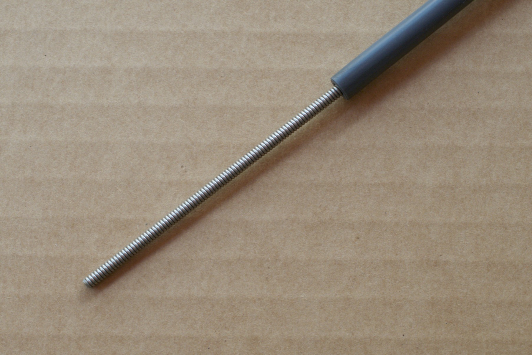

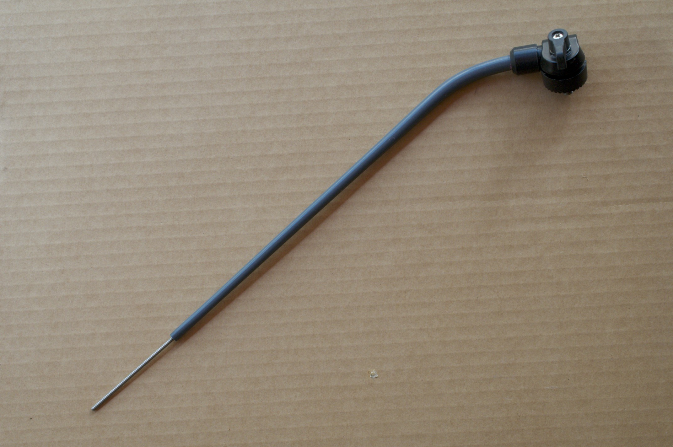

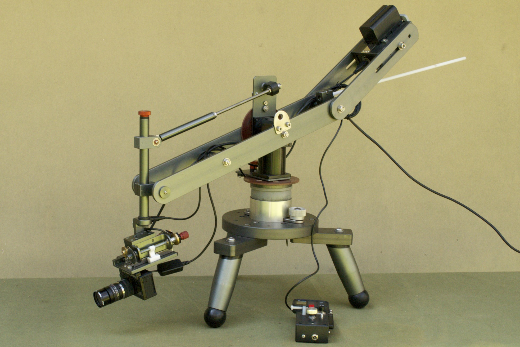

Hi Paul,
I use flexible handles on my tripod heads and mini-boom to make smooth action easier. The idea is a step-up from using a rubber band to drag the handle in the desired direction. The introduction of bit of elasticity makes it much harder to transmit any hand tremor to the head and tripod. It also makes it easier to apply a steady force to the tripod handle. The tapered grey handle shown in the pictures is made from PVC – a terminal spring permits finer control if needed. I have forgotten the name of the white plastic handle used on my mini-boom.
http://www.dvinfo.net/forum/images/a...attach/jpg.gif
Help: Looking for tips for smooth panning and tilting-_dsc1448.jpg   Help: Looking for tips for smooth panning and tilting-_dsc1479.jpg
Help: Looking for tips for smooth panning and tilting-_dsc9913.jpg   Help: Looking for tips for smooth panning and tilting-_dsc9917.jpg
