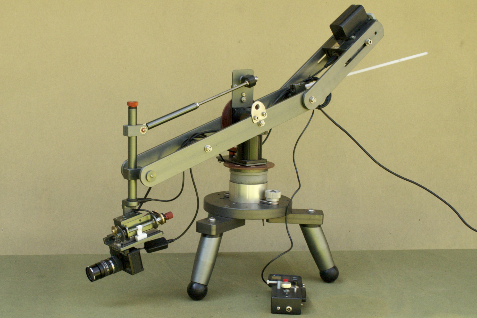

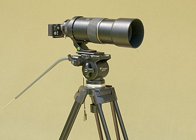

I have found that the choice of tripod handle is a very important and very much overlooked element in achieving smooth panning.
One of the pictures below is of a Weifeng tripod from the low price end of the market. The camera is a GoPro fitted with a 300mm Nikon lens. The handle is not the supplied Weifeng issue but one made out of a tapered piece of PVC and fitted with an even more flexible extremity. The flexibility of this set-up absorbs most of the tremors transmitted by the operator and smooths a lot of the stiction present in the head. The result is a much smoother action than that achievable with the Weifeng handle. The other picture is of a mini fluid-damped boom set-up. I use it for macro work – the camera is a GoPro mounted on a motorized ball-slide used for focusing. To position the boom I use the flexible white plastic rod seen protruding from the rear of the boom. Again the flexibility of the handle makes for smoother control of the boom than a rigid handle.

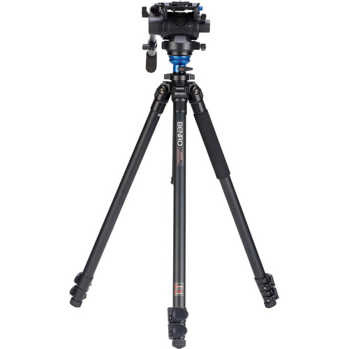

If you are carrying your gear any significant distance then "weight" can be a big consideration. I have gone thru 3 tripods over the years and found the best solution for me is the Benro A2573FS6 S6. It has a ball head for easy leveling and is now on sale for $285 at B&H. It is not a great tripod but for the money it is a good value. Also, I found out parts are readily available when I bent a leg and the replacement was only $30 shipped. When I don't need the S6 head I just screw on my cheap and lighter photo head and the ball leveling still works great.
