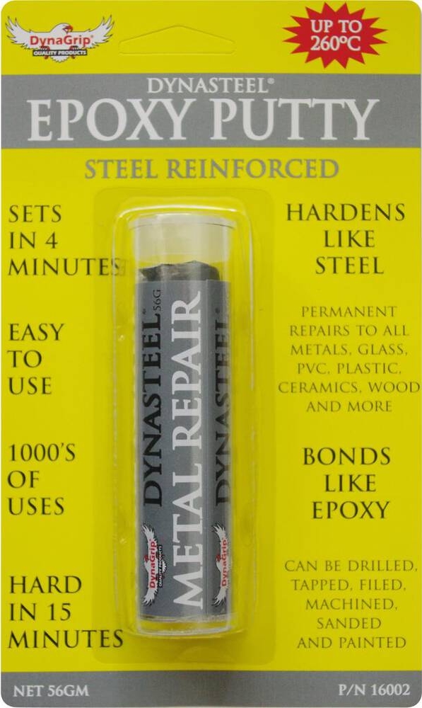

Yes, I've run into this problem before and had to come up with a quick solution to save the day for one camera. On that occasion an idea popped into my head, having used this material before, and it worked. And worked for ages I heard later.
I purchased some DynaGrip Dynasteel Epoxy Putty from our local DIY store. Sliced off a slab of the epoxy, moulded into a disc of similar size as the spline rosette on the tripod head, punched a hole through it then clamped it in between the tripod head rosette and the tripod handle rosette and screwed up the clamp.
In compressing the epoxy between the head and the pan bar rosettes, the epoxy putty was pressure moulded with the two rosette patterns. I left it for about an hour. Sure enough, the epoxy had set solid. Slackening off the pan bar locking screw and giving the pan bar a jiggle freed up the pan bar assembly for removal. What we now had was a metal like epoxy disc about 7 mm in thickness which had two different rosette patterns moulded into the opposing faces of this epoxy disc. This epoxy ends up hard enough to file, drill, sand and grind.
There are numerous different metal epoxy material around. Some, like the Dynasteel I used, reinforced with steel. Check out your local DIY for something similar.
Chris Young
Ingenious! Clever! Resourceful! I am going to do that. Thank you!

Looks like Dynasteel is not available in the US. I will try JB Weld Steel Stik. One other modification required: the Miller head uses a 1/4-20 threaded attachment screw, which the older Manfrotto had, but the new Manfrotto uses a different thread. Easy enough to make a new one out of a 1/4-20 hex head bolt.
Thanks again!

It's funny, sometimes being pushed into a corner forces you to come up with a solution. I hear what you say about the Dynasteel but as you mentioned there will be a suitable alternative available. Yes, the bolt can be an issue.
