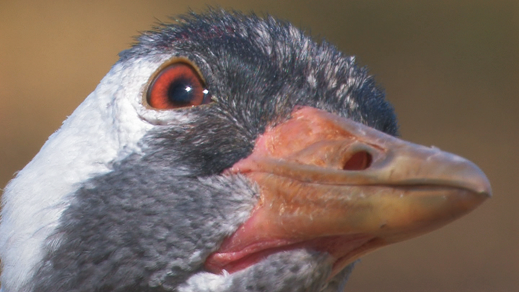

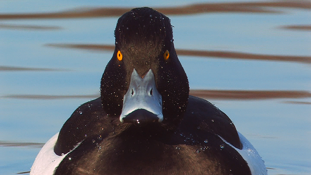

Helen, here are two sample pictures taken with extreme telephotolenses.
Both picture are shoot with Canon XLH1 camcorder at 1080/50i, 1/50 shutter, polarization filter used.
It's a capture from the original footage, nothing done in post except adjusting levels and brightness a bit on PS.
Bofh picture is shoot with a Canon 500mm f/4.0 lens.
MrDuck to the left was sitting almost still of a distance of approx. 10 meter. The light was good, early evening which helped me to shoot with an aperture of around 8 if I remember right. This gives a good depth of field (DOF).
MrCrane was a bit difficult to get a good shoot of. His head was constantly in movement, even in this shoot you can view a slightly unsharpness cause of the movement. I was at shutter 1/50 and around aperture 8 for some DOF. The bird was so near, around 5-6 meter that it was difficult to frame it properly. I'm not sure if increasing the shutter speed would have helped me out, this would have forced my to use a larger aperture and loss of DOF.
As said before to use extreme telephotolenses require lot of practise. In wildlifefilming you're not dealing with talents who do (mostly!) what you want to do. But totally unanticipated creatures wich almost everytime don't want to play your game!!!
Please keep us updated about your effort Helen. I also hope that others chime in who has used any digiscoping for wildlifefilming.
