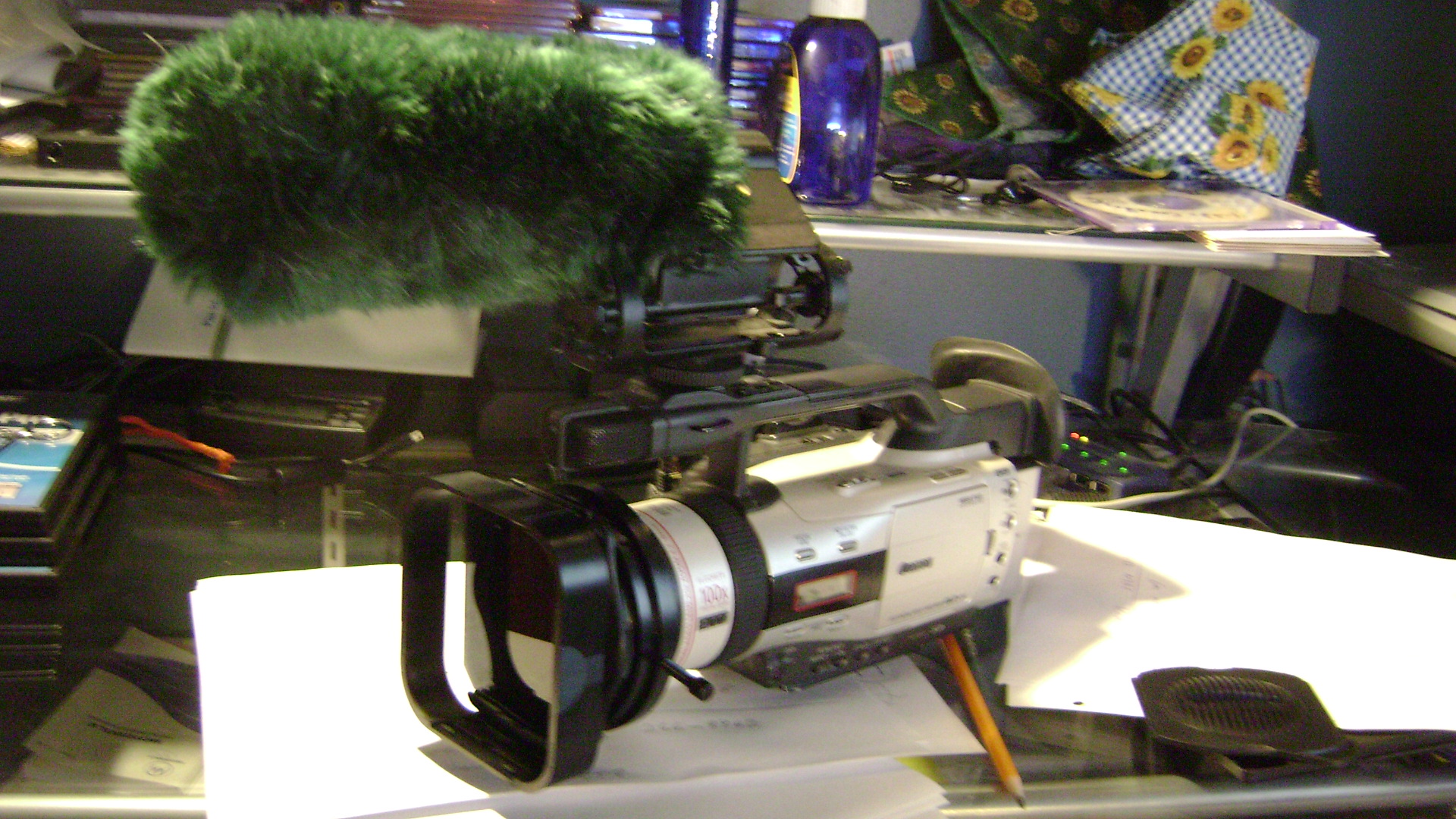

I am not sure about your thread size. I use a gl2 with a 2x century and while it will take 72mm filters that doesn't have a hood then.
so I purchased a conkin p series filter holder and hood that mounts on the front with three screws. The hood is extendable so you can make it deeper or mor shallow for wider shots.
the filter holder will hold two filters. It takes 3x3 filters and I have a few different filters, ND is one of them, a polizer, and a 3x close up, a warming filter and a sky light.
It works just fine. The whole set up is under 50 bucks if I recall. I also use it for an anamorphic lens and a wide angle lens, so it has several uses.
were I to buy again I would get the z version that takes 4x4 filters so I could use it on my lx2 as well.
Here is a picture of it.
