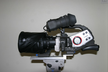

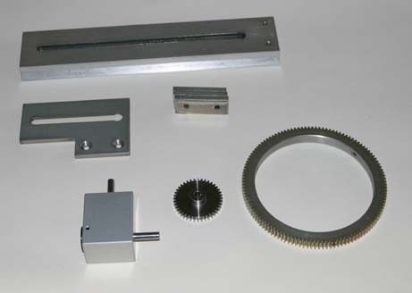

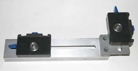

My rail attachment for XL2/ Tamron 300 mm
Hi
My solution to attach a Canon XL2/Tamron 300 mm on a Vinten tripod.
The bevel gear box is used to focus the lens, the end ratio is 3 to 1 but in changing the little gear i can obtain 6 to 1. I have to do a knob to turn the axis and a support. The rail come directly in place on the fluid head without adapter (it's a dove tail machined for the Vinten).
I have a set of holds to compensate the heigt difference between the Cam and the lens.
All the parts have to be anodized.
The ring gear is a 120 tooth M1 and the little is a 40 M1 i have machined a 30 and a 20 M1 to obtain ratio 3/1, 4/1, 6/1. The total weight is 1200 g.

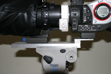

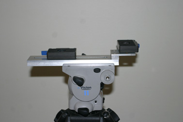

Hi
The XL2 mounted and unmounted on the Vinten Vision 11. The dove tail fit directly on the head, the distance between the two support can be adjusted in lenght and lateral offset for the height i use holds.

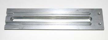

Hi Dale
The slot is 200 mm long and the other is 50 mm long. I can adapt many lens, zoom and prime, i have a doubt for the 600 mm Canon prime lens, but you can do a bigger plate, for the height i use holds, that's more rigid than sliding rail. The two black parts are "quick clamps"
Regards
Gilles
