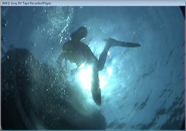

Here's an example of the problem I described earlier re. bright areas around the sun (typically) looking very turquoise instead of the bluer surroundings. It doesn't seem so bad on a PC display (LCD or CRT) but looks absolutely dreadful when watched on a CRT TV yet doesn't show up on the camcorder's display. In reviewing footage from my c. 1993 Video8 Handycam, I notice that it doesn't suffer this problem at all. I originally put it down to my using a first generation DV camcorder but I see it a lot on places like Discovery. Just last night I saw a trailer for an upcoming series that shows exactly the same behavior. To me, it completely destroys the video. I'm surprised it is permitted for broadcast.

You have actually got a few things going on in that frame, firstly the halo effect is a reflection of the camera lens and front edge of the cam. If your camera is silver at the front one thing you can do is make it black, whether with a permanent marker pen of black tape (depending on how neat / permanent). Secondly the vignette, to solve that zoom in slightly, this is a reasonable common problem, if the lens was designed for the housing then it shouldn't do it. As Ron said Fathom ports are fantastic and do not have this problem. Unfortunately U/W gear is bloody expensive and it does come down to the more you pay the better it gets.
Also when shooting into sun any blemish or bit if dust will show on the port you will need to be careful of that.....
It's funny you mention about broadcast, heaps of crap gets through and in the U/W world it's who you know and your name probably more than your shooting ability. If you actually look closely at the "Blue Planet" a very highly regarded underwater BBC production there are lots of very average shots. Don't get me wrong I think it's great but there are some really bad (technically) shots in it.
