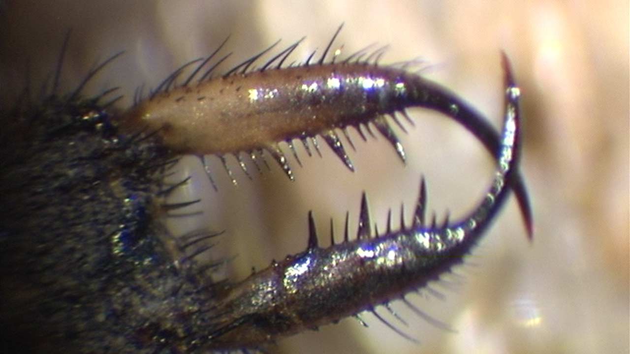

Hi
I use an Euromex with an B4 adapter. The camera is mounted directly to the microscope. This gives me the problem that there is no Iris on the system. My depth of field is almost nothing and it's a little annoying as I can easy put more light on the subject. I have not seen anything yet that really can do the job. I need to put my own cameras on to get HD and 16:9 - and 25P frames....
My pictures are just not as crispy and sharp as I dream off.
The picture is from a 4:3 video - cropped to 16:9 of an insect larvae thats digging holes in the sand and lying there - waiting for an ant to fall down in it...

Depth of field is extremely shallow using a microscope. In the lab doing coverslipped wet mounts, we would focus up and down through individual layers in the single drop of specimen. The depth of the region in focus would be about the same thickness as a single cell.

I know - I just wonder if I had an iris - would I be able to change dof ?

Not with a microscope. With a microscope. With a microscope, even on the lowest power, it would be like extreme telephoto on your camera. If ocular is standard 10X, and objective is at the lowest magnification, typically 10X, then you are zoomed in 100X. Ocular and objective are multiplied together. Imagine what the depth of field on your camera would be with a 100X zoom lens. You wouldn't have very much depth of field, would you?
I don't believe it is physically possible to have a shallow depth of field with a microscope. I used them for hours daily for 30 years.
