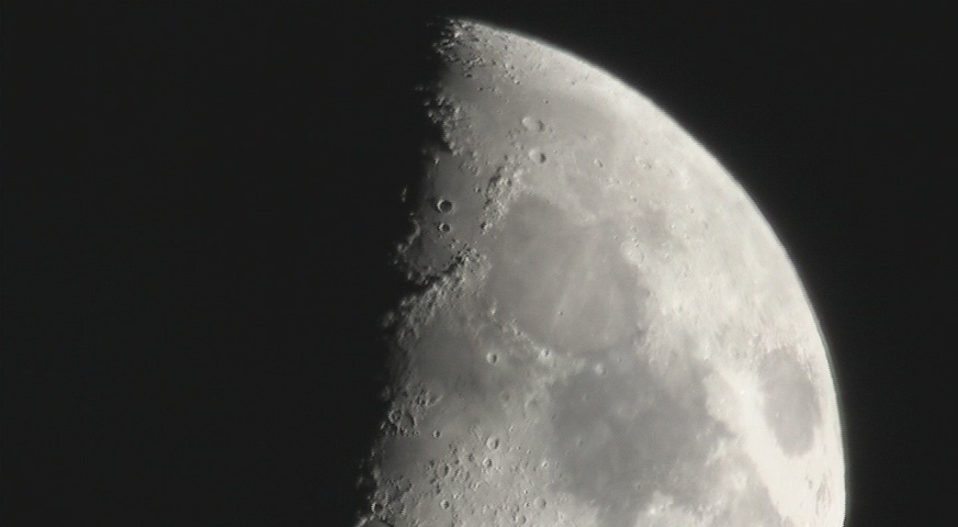

Here is a frame shot of the moon using the Canon XL2 with a Canon 100 to 400 4.0 and a Canon 1.4 extender.
