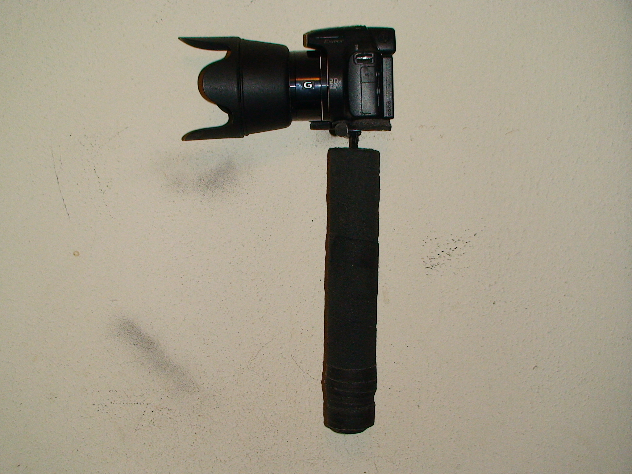

For inside a vehicle, you might try something like the steadying rod I use for cameras and camcorders in tight quarters, where I can't work with anything larger. This photo shows it with an HD-shooting photo camera. There's a 1/4-inch bolt embedded in the wood core of the metal tube and a large fender-washer and wingnut are used to attach it and spread out the stress over a wide area on the bottom of the camera. I wrapped it with tennis racquet gripping tape.
