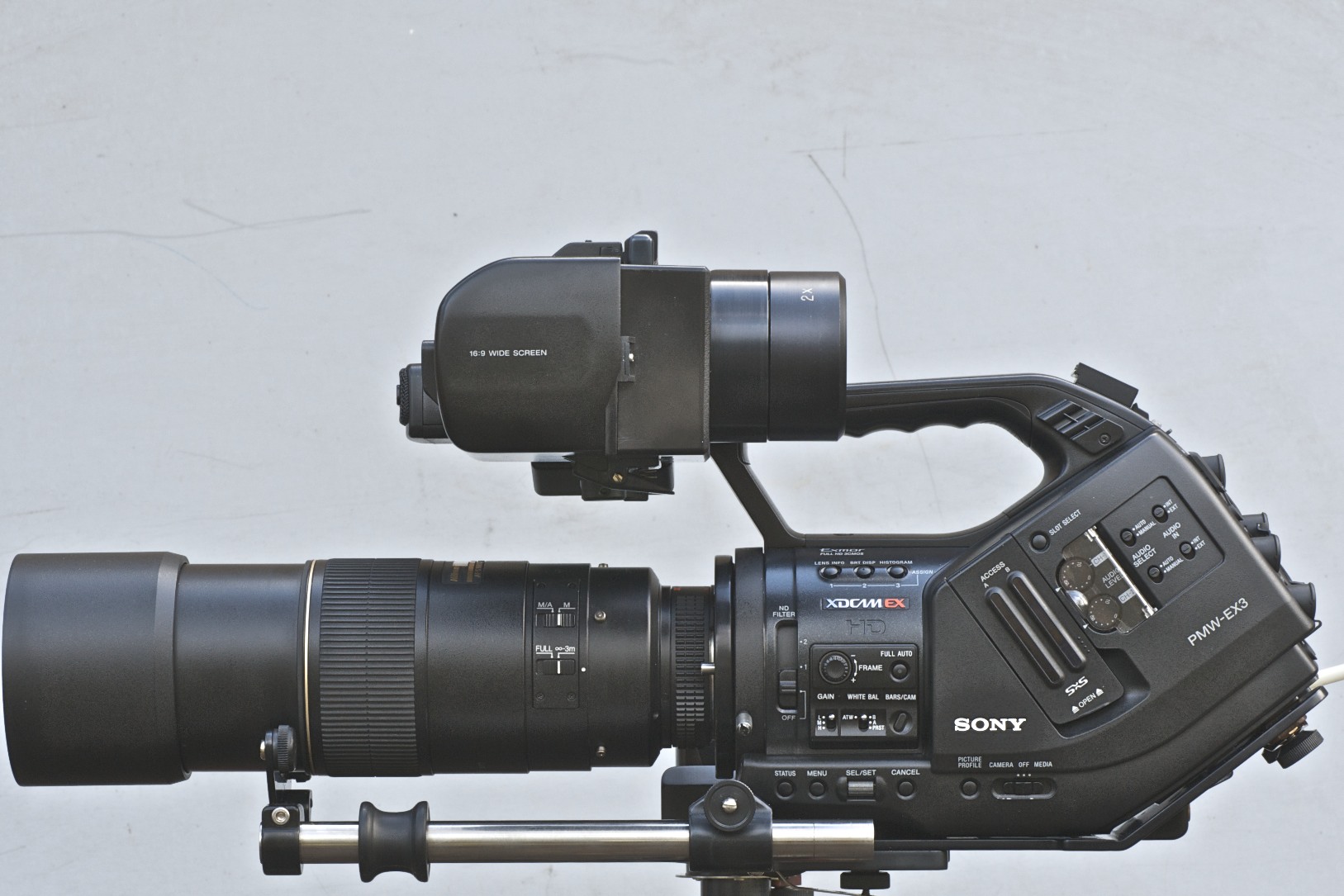

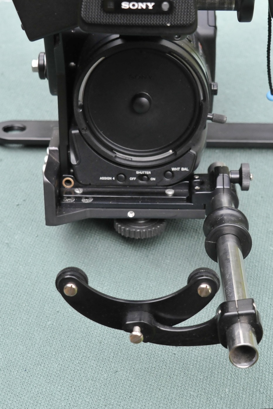

I use a lens support that is based on a single stainless steel tube set up parallel to the lens axis. To adjust the tube is rotated until the self-aligning crescent shaped carriage takes the weight of the lens. Installing and adjusting is very quick. To work the tube has to be to one side of the camera, in the this case it is far enough to one side to act as a useful sighting aid – very helpful for finding the subject in the absence of a zoom. More recently I have made a very low level mintripod for macro work that utilizes the tube as a support for the front leg.
