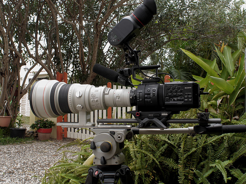

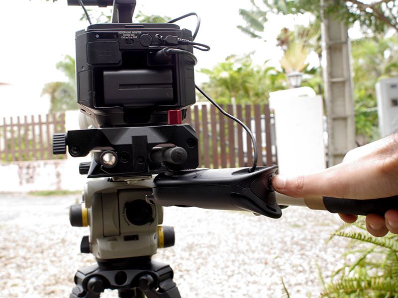

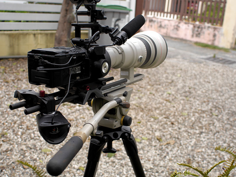

Now, what are the options with telephotos*? I personnaly work with beautiful Nikon 50 300 f4.5 and Canon 400mm 2.8 (with TC X1.4 or X2) Max reach will be 800mm at 5.6. This is plenty... at least for me. Next problem is weight... At longest lens settings, my set up weights 15kg. Not very mobile, this is the real trade off perhaps. Or... as Sabsayachi Patra says, just hire Arnold Schwarzenegger for a day or two in order to relax / and or just go to some serious gym sessions before breaking your back... At least the full set up fits in my backpack for some sympathic if not painful daywalks...
