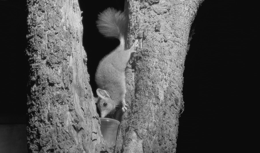

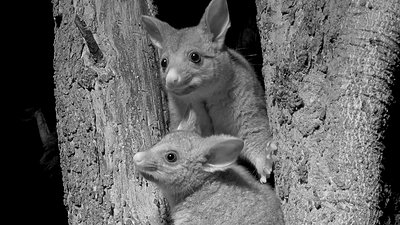

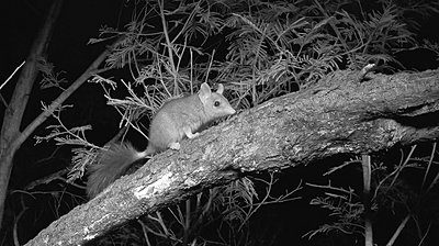

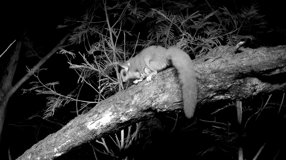

I had trouble loading pictures into my last post of this thread so I am trying again here: -
Four IR illuminated screen shots from a Back-bone modified ‘GoPro 4 black’ using a Ninja Inferno for recording. To compensate for the light path changes resulting from the IR cut filter removal 0.0085” was removed from the lens mount.
Lens used was a 4.5 – 10 mm Infrared corrected Vari-focal.

IR video problem solved?-screen-shot-2018-10-27-9.12.55-pm.jpg   IR video problem solved?-screen-shot-2018-10-27-9.29.52-pm.jpg
IR video problem solved?-screen-shot-2018-10-27-9.54.11-pm.jpg   IR video problem solved?-screen-shot-2018-10-27-9.56.46-pm.jpg

Gosh, very are very sharp and clear Alistair! looks like all your experimenting has paid off

Hi Mick and Bo,
Thanks for the interest. It was all a bit of a fiddle but I am pleased with the detail that is now possible with this relatively modest set-up.
Back-bone are now recommending an alternative approach that I am yet to explore. They are currently marketing IR Cut filters and Visible Light Cut filters for behind the lens use. They are also working on a new filter mount.
The advantage with this approach is that you use one filter or the other and if their refractive properties are the same there will be no need to change flange depth when changing from visible to IR or vice versa.
However as a lot of my clips are taken around dusk when the amount of visible light is falling steadily I worry that they will suggest that my subjects emerge later than they really do if I use a visible light cut filter. On the other hand with the amount of daylight being so variable at dusk it is hard to intercut shots taken even at slightly different times so may be getting rid of visible light could be of benefit.
