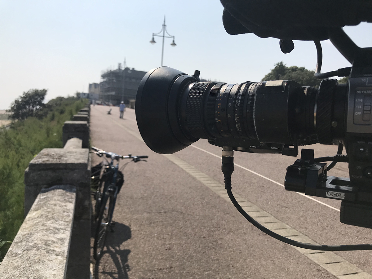

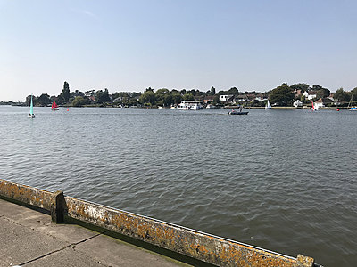

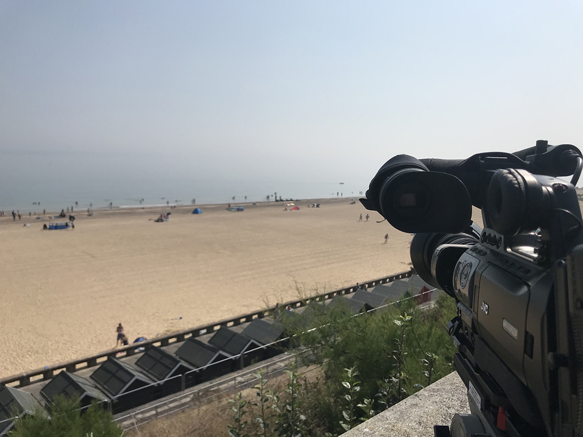

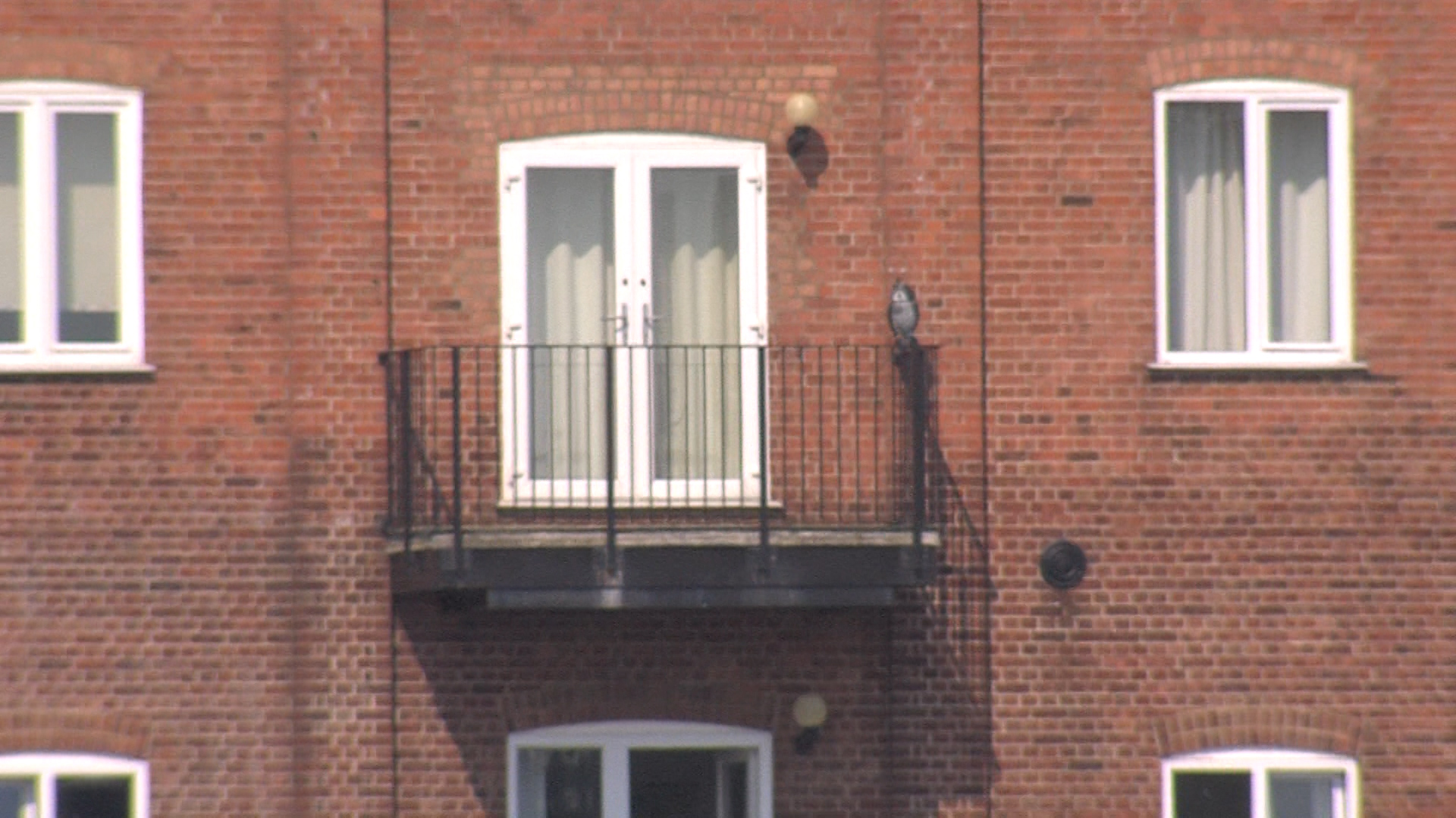

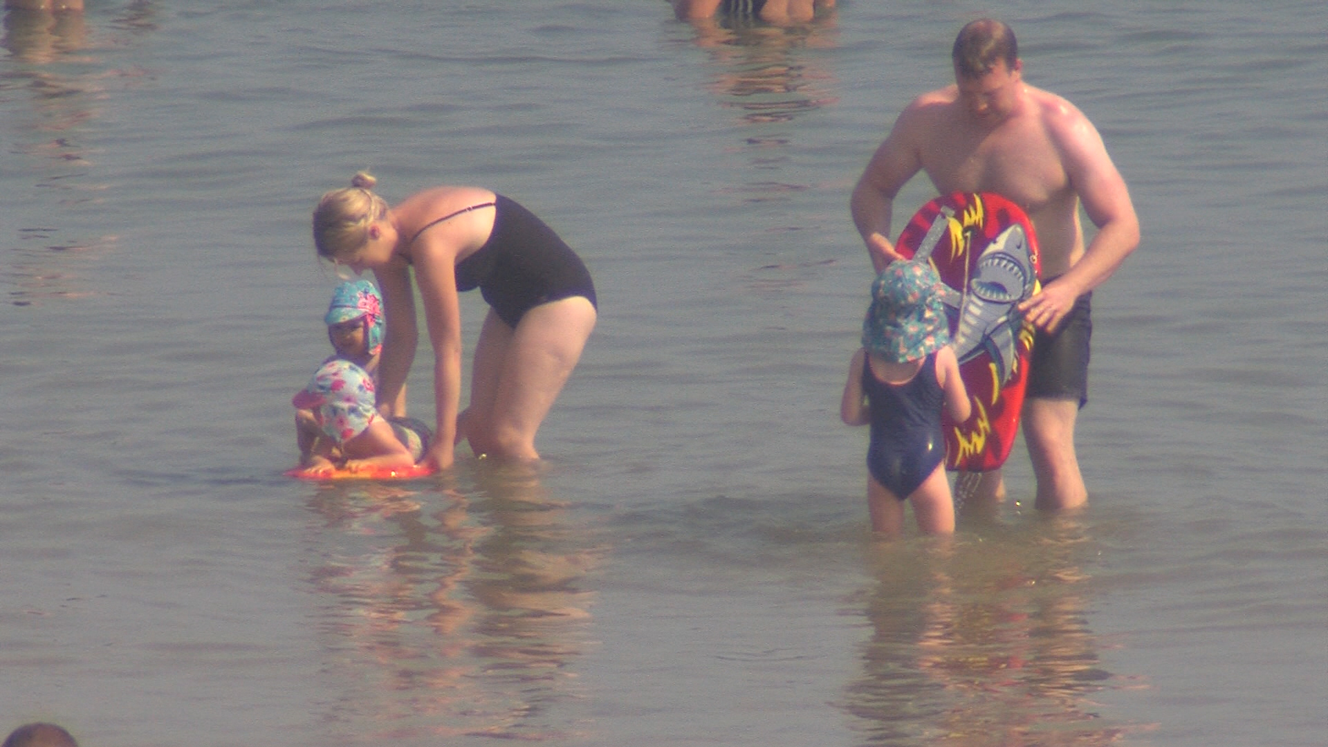

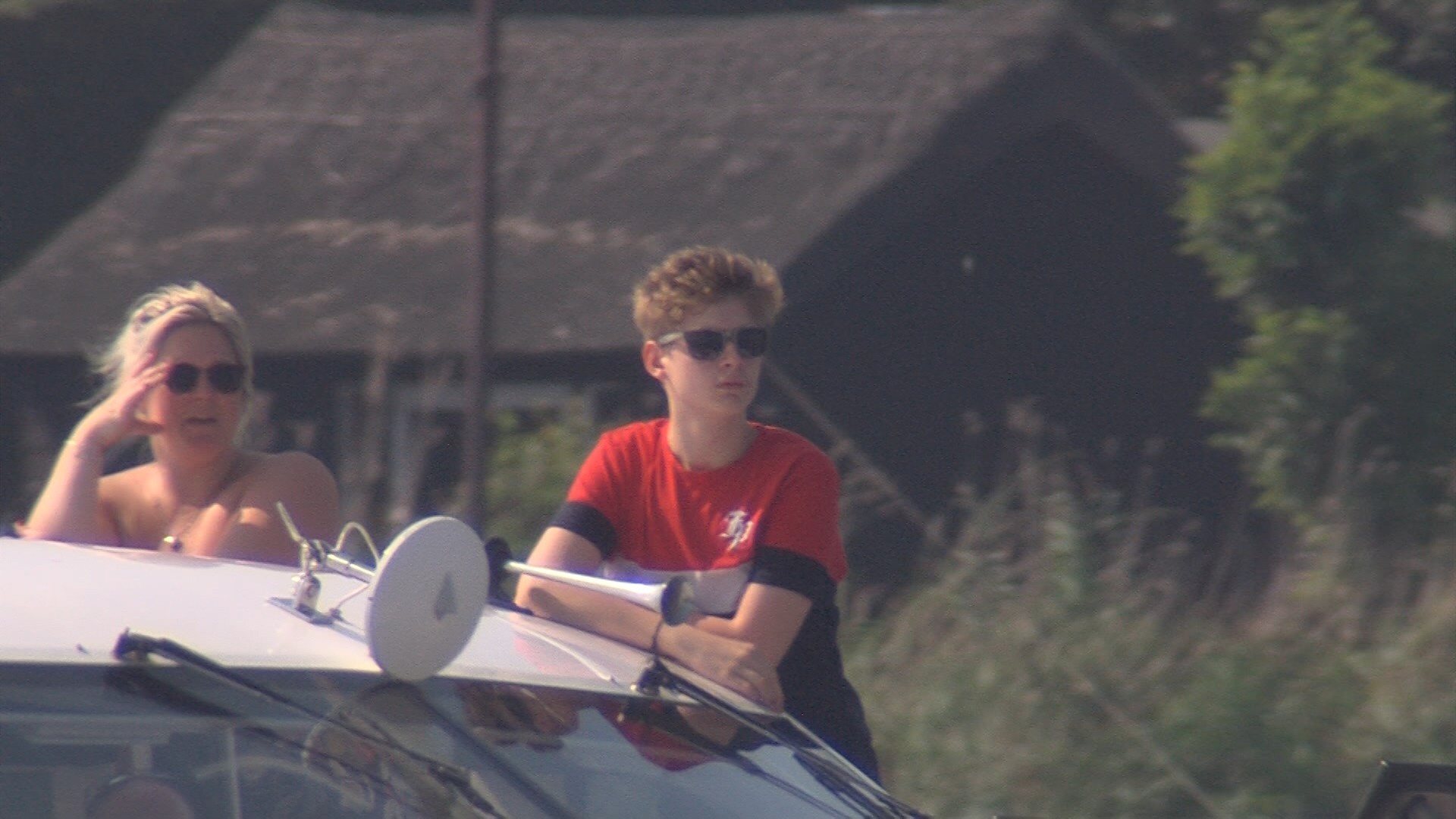

I got a new lens adaptor today, something I meant to do before, but Ryan's post kind of gave me a kick. A B4 ⅔" lens adaptor to it fits on my ⅓" JVC. I expected the results to be poor. I'd been told to expect a very soft image with my old Canon lens, and all kinds of nasty coloured fringing and odd artefacts. I'd also been told that the 2X lens extender wouldn't work.
I tried the beach, but heat haze - 31.5 degrees C here today - made this location not too good, so I went to the local broads and no haze.
I also took some photos with my iPhone to show you what it could see, as most people are familiar with the field of view of phone cameras.
The collection of clips from the better location shows how sharp an SD B4 lens can be on a small sensor camera. I'm struggling with the maths a bit to calculate the equivalent focal length compared to 35mm, but once you zoom out even a little, the image quality is not anywhere near the issue I thought it would be, and for wildlife stuff - it would be rather useful, but even my Vinten 5LF head is not stable enough for lurch free pans and tilts, unless I wind in some friction and then pan by turning the head, rather than the pan bar - using the pan bar is very 'touchy'.
The collection of clips is here - using the 1x and 2 x converter

You can also fit these lenses on large sensor cameras using a suitable adapter. Obviously it would be the HD or 4k ENG/EFP lenses that you would use for higher end work, these lenses are used by wildlife camera people.

In a way - I've done a Ryan. A friend of mine with the same camera tried one of these adaptors and bought a second hand B4 lens on Ebay. He told me the results were disappointing, and I took his experience as typical of ALL B4 ⅔" lenses, when clearly, this one is quite usable.
I have no idea what's inside, but in the store are two more large Sony flight cases - I think one is empty having scrapped the other Betacam a couple of years ago, but the other is heavy - and clearly has something in it. I will drag these out and have a look inside. It could give me another lens to try?
All I can do is encourage Ryan to not give up and try something a bit different. Try alternatives, and don't believe everything people tell you. I'm already thinking of things I can do with this. I also know that I like to thin k that I'm pretty good with normal lenses, but this afternoon showed me that working with long lenses is a totally different technique when you don't have the mass of a box lens on a Vector head!
