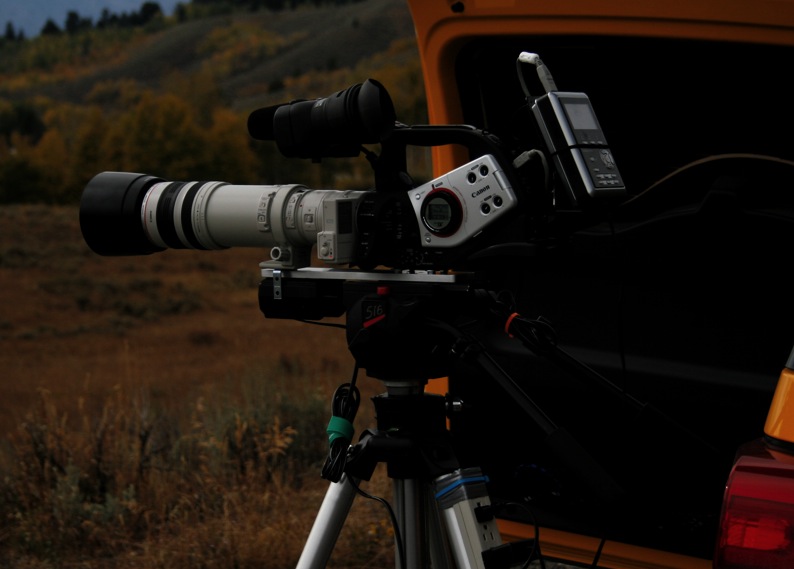

I shoot the bears at cattlemans bridge near Ox Bow, I would love to meet up with anyone who could help or show me how to better use my camera.
Right now I have a mount that works the same way, I don't think I can afford one of those other ones right now, but I will start budgeting for one.

I agree with the others that there is too much camera shake and both contrast and sharpness is low in most of the bear footage (slightly underexposing the subject or upping contrast in post may help sometimes).
It is often much better to frame your subjects and lock the tripod head tight and then let the subjects move in and out of frame. When the subjects (bears) move out of shot, simply reframe and lock-down again. Also try to interpret the direction they are moving and let them move into the empty frame.
Try to avoid panning most of the time if possible, although some slow and steady panning can add impact to some sequences (often it is the start and end of each pan that has shake, so sometimes a pan can be saved at the post editing stages by only using the central portion of a pan and then fading this into the next clip). Remember that that the wider the angle, the easier it is to pan, so only use the extreme telephoto end sparingly until you have practiced long and hard with technique.
I also noticed that the exposure shifted each time that the bears moved. Once you have sorted the correct exposure (it should remain stable in overcast or clear conditions) it is wise to then press the Exposure Lock button for the rest of the sequence.
Use a polarizer to intensify colours and contrast (A UV filter can also help cut through some haze).
Above all else, if possible (taking consideration of safety etc), try to get closer to your subject to improve image quality, lessen camera shake and avoid haze.
Another option is to use a remote-controlled tripod-mounted camera + shorter lens setup (although this means only a static framing can be used…unless you also employ a battery-powered revolving pan-head).
Time of day can also be a factor, and shooting at the start and end of each day can help avoid haze…although mid-morning or early-afternoon bright sun shining over your shoulder and falling directly on the subjects can often provide awesome deeply saturated colours when in combination with a polarizer (just watch out for harsh shadows, especially if the animals are moving in and out of forest cover or bushes etc).
Wind is also another big problem when using the longer lenses, so even if your subjects are in the wind, try to position the video camera somewhere where the lens is not being buffeted by side winds (taking off the lens hood also helps as it shortens the lens during high winds and sometimes a sandbag or beanbag draped over the lens/camera helps absorb shake). Adjusting the tripod to its lowest setting and splaying the tripod legs for low-level shooting also helps.
