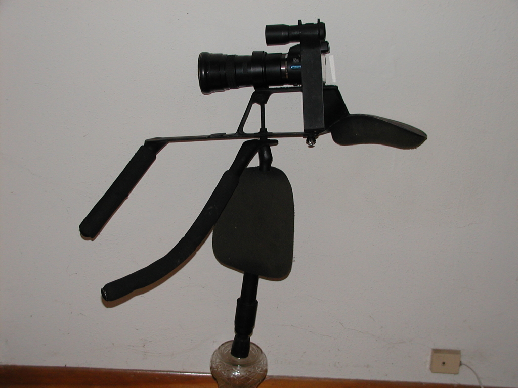

Here's My Framing Scope

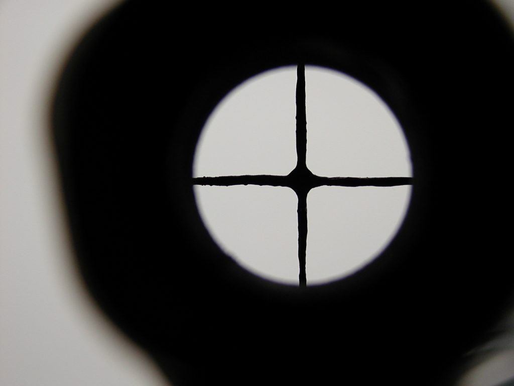

I made this with a cylinder from an old pair of mini-binoculars. It's on a microphone mount I had built, that just happened to fit the purpose exactly. I stretched heavy thread for crosshairs on the end of a smaller tube that fit inside and sprayed dozens of coats of black paint from front and back, until they thickened up and cooperated by forming sort of a dot in the center.
There's no glass in it and I need to re-calibrate it a bit before each shooting session. Since its purpose is just to get my camera pointed somewhere in the ballpark of the elusive, flying subject, it does its duty nicely. Total cost: not one cent out of pocket.
It's shown here on my shoulder-mount, with a Sony H5 digital camera and a Raynox 2.2X telextender. With 26.4X total magnification, this framing scope is specially useful. I put the camera on continuous autofocus and usually never look in the camera's viewfinder before I click it off. A good percentage of shots come out as keepers and actually have the birds, planes, UFOs or whatever, close to the center.

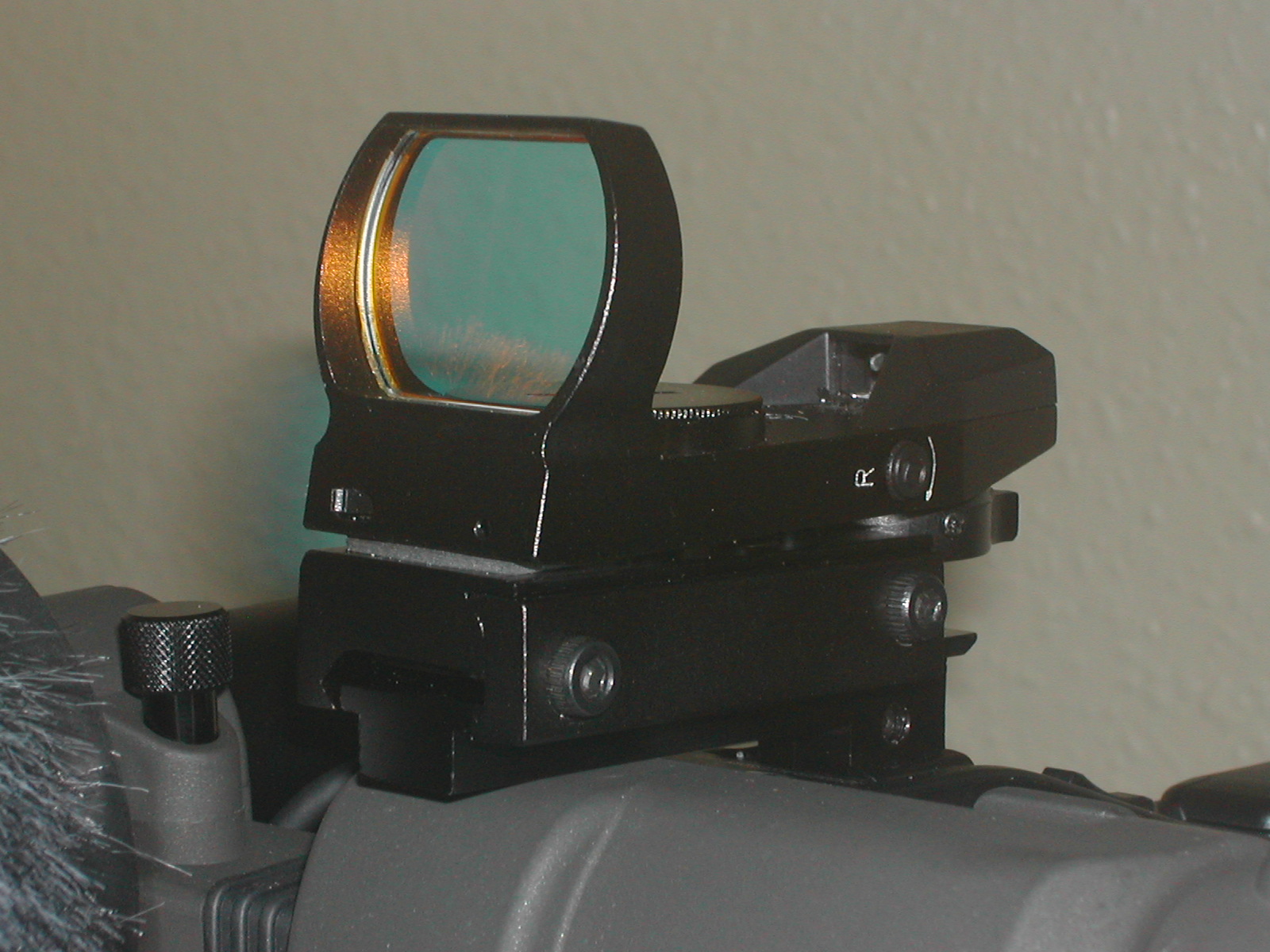

Hi all
Thought you might like to see a photograph of the Red Dot Sight and
the Xtend-a Sight mount fitted to my camera.
Works great.

Henry, it looks like a solid little attachment and the fine-adjustment knobs must be handy. How well does it work for all the various types of shots? Can you just ignore it, if it isn't needed?

Hi Stephen
Yes it's very solid, all metal construction, One slight drawback is it needs
an Allen key to make adjustments but I set it to allign with the camera
viewfinder at about 100 metres and only use it to FIND the subject and then
use the camers viewfinder to frame and focus etc.
