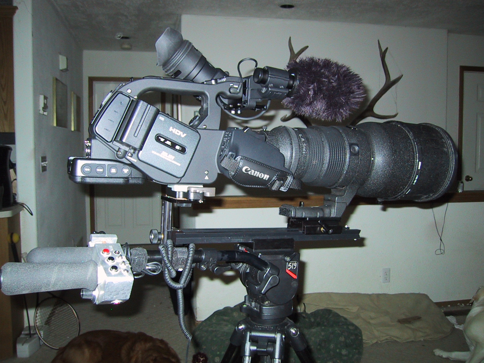

You might consider the Bogen 519. Works well with the H1. I also have a Sachtler DV-8 which is great but for the price difference, I find the 519 to do just as good.

Chris, I believe it's as smooth as the Sachtler for the given weight. Much more control than the 510, in fact not in the same class. I believe this might fit your budget. I will say the Sachtler has a wider window whereas the 519 must be fine tuned just right but once you do its great.

Bill hit the nail right on the head. The 519 is excellent, but you need to adjust the pan and tilt just right (read tighter than you think appropriate) for optimal performance with moving or elevated subjects.
