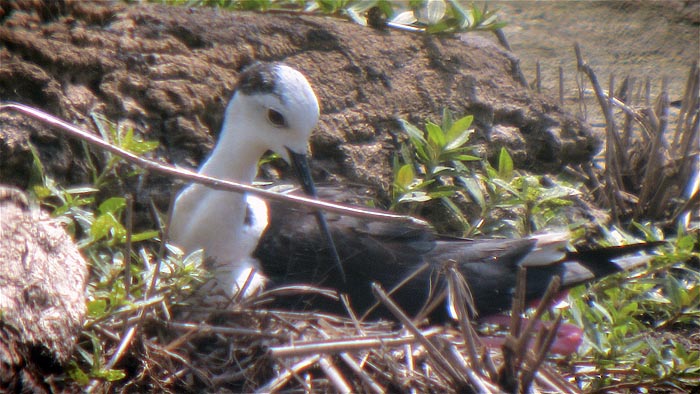

Further to my earlier post about using the HV10 coupled to a Swarovski scope, well attached is a shot with the Canon HV10 coupled with a Swarovski ATS 80HD scope and 20x eyepiece. It produces a focal length of
Lens Type
Focal Length: 6.1 - 61mm (35mm Equivalent: 43.6 - 436mm)
Scope 20x eyepiece
Resulting picture equivalent to 436 x 20 = 8720mm
But the aberations are not acceptable except for "record" shots.
Attachment is full frame (no crop) of nesting Black-winged Stilt
