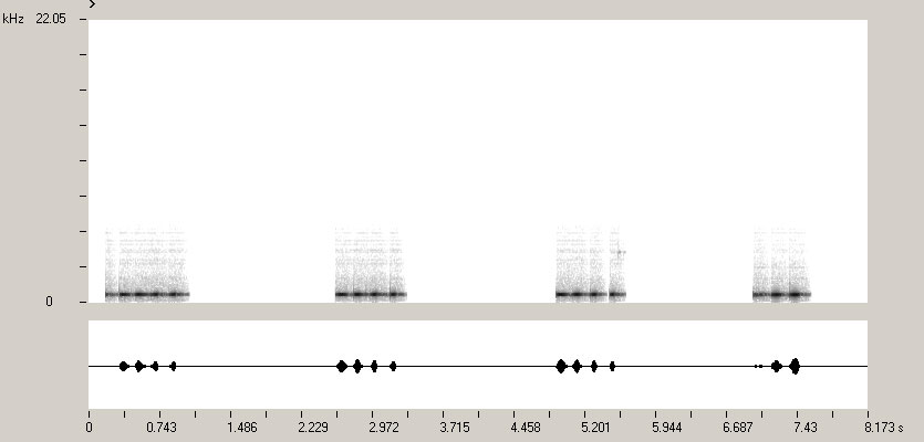

Good fun this audio editing. I've had another go. I've also included a sonogram made with SeaWave
http://www.nauta-rcs.it/SEA/seawave_index.html
