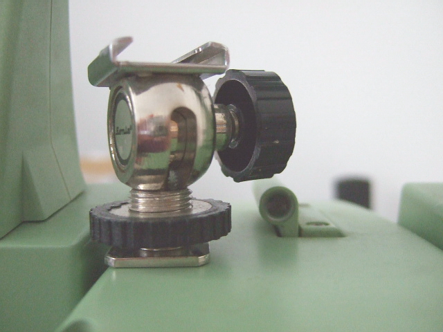

The first part (see attached pics , and sorry I don't know what name to give it)
attaches to the camera hot shoe and acts like a tiny tripod head , it has the ability to tern on both the horizontal plane and the vertical plane, I got it from a nearby camera store for 4$.
The second part is the sight itself. It is used on theodolites and other land survey devices (like the one on the attached pic), some of those sights have adjustment screws , but for our purpose we need the simplest (and cheapest, mine I got for free from a Leica distributor).
The sight have no optics , you see the real world around the sight and not through it. But if it is aligned with the target you will see a white cross (put the white cross on the target and that's it).
I glued the two parts together.
Now when you prepare your camera to shoot, attache this device to the cameras hot-shoe and adjust to a stationary target roughly at the distance you intend to work on your real target. Adjusting won't be smooth nor accurate as with red dots , and again if the target will be closer than you planned than the cross will appear above it...
Cheers Sassi

Thanks alot Sassi! The first image look like a head for a flash and is mountable on a camera's hotshoe. Think I may have seen something like that around but cant recall.
But the issue of parallax error is still there as the focusing distances will vary. Maybe Im missing something here?
