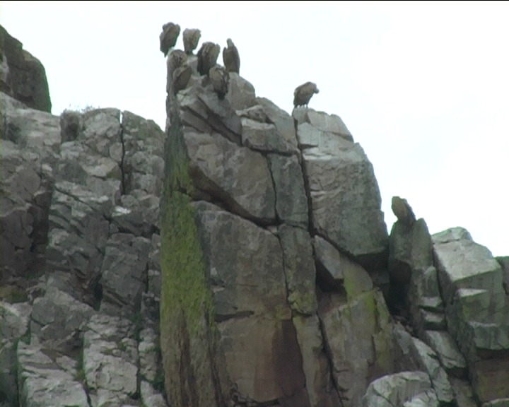

This may help to identify my problem ....
.... here is one frame (from a clip) showing that even without flight to distract me I am not doing something I should be doing to show a bit of detail on the birds ... the cliff is 150 yards away and I'm at x20 on XM2 (GL2) on a tripod. Isn't two-thirds of this frame made up of solid greys? what am I failing to do to counteract the brightness of the sky? The sun is well clouded over and it's mid-afternoon facing approx. south in April in Spain ... I have done no editing at all in post ...

The range from shadow to highlight is just too great for any sensor to handle. As the birds are at the very top of the cliff, there is not much a ND grad can do even though you may try using a 2 or 3 stop soft-grad to bring down the brightness of the sky. The jagged rock formations will however rule that out.
The only way I can think off at this time is to shoot when the sun is lower in the sky and with it behind you.

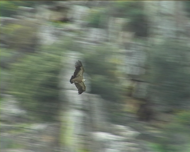

I believe you WeeHan and thank you for explaining the difficulty ... here's another unedited frame, shot handheld from the same location within same half-hour ... please take a minute to describe why so much detail can be seen on this bird ... you are good at describing images, if you can find the time ?? And what settings would you try out to improve this sort of shot?

The 2nd one looks like you're shooting against the cliffs or a hill of some sort which is much, much darker than the sky. That's why you have detail on the bird because the background and the bird are closer together as far as exposure goes. Whereas the sky is dozens of times brighter than the bird and you're camera can't handle the range of both.
