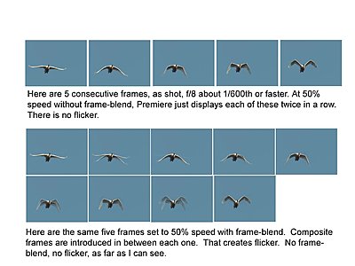

Dale,
Thanks for putting together those clips. I saw wing-flicker (which I call "ghosting". Is it the same thing?) in only one of your clips, the one "time-stretched" to 52% (which is probably the same as Premiere Pro's speed=50% setting). All the rest of yours had discrete wings, no matter what you did to them. What I don't understand about your explanation is the idea of reducing flicker by reducing the shutter speed. Using a low shutter speed will blur the image a bit, but it won't affect where wings appear in subsequent frames.
I went back to my own clips and lo and behold, no ghosting or flicker at all. I have put together a Photoshop collage of sequential frames from swan and goose clips to show this.
Image hosting, free photo sharing & video sharing at Photobucket
The top row is 5 sequential frames. There is no flicker. If you choose to slow it down to 50%, Premiere simply displays each frame twice. There is still no flicker, you only see each frame twice as long. This is what I did in the video. If on the other hand (second group of stills), you choose "frame blending" and then set 50% speed, Premiere interpolates by showing a composite of the fore frame and the after frame in between the two. Full of flicker. I just recently learned this, all my previous videos were frame-blended, and flickery, but I don't see any in this one.
Even though there is no real flicker in the clip, I still can see what you are talking about. It is easy to sense the wingtip still at the top of the stroke, even though the wing has moved down. Since this is not double imaging in the clips, it must be something in how we perceive the motion. I looked again at your gyrfalcon (jeez, I need that for a lifer) you can see flicker, but by starting and stopping quickly to freeze individual frames, none of them have four wings. I wonder then if seeing flicker has nothing at all to do with shutter speed, or frame speed and everything to do with our brains. I notice all the time that live grackles or cormorants flying across a clear sky seem to have four wings. It's simply a perception thing. Of course that raises the question, if you can see it in nature, is it acceptable in video or not?
As another investigation, since there is a question as to whether 60i is better than 30p for flight, I went to a set I shot in 60i last year of a hovering Kestrel, and looked frame by frame. Whether deinterlaced or not, frame-blended or not, 100% or 50% speed there was unacceptable flicker showing as ghosting wings in every frame.
It seems that Per Johan's solution, slowing the motion to 25% solves the flicker problem because everything is so slow. The difficulty I have with that is that the audience will accept 50% speed as real because so few people actually pay attention to bird flight, but 25% is obviously slomo, and not appropriate in all situations.
