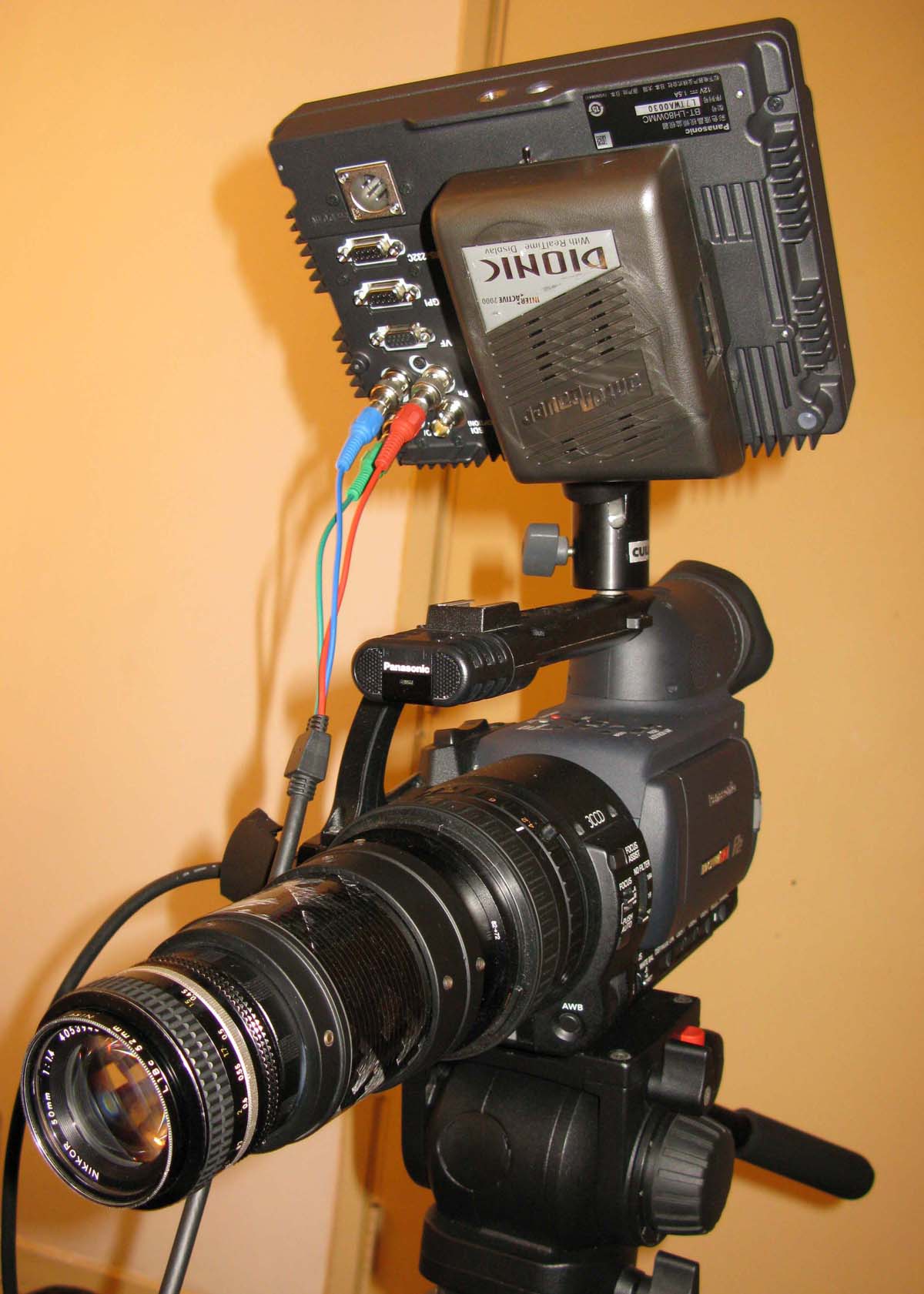

Sorry for the late response, Tingsern Wong... Didn't see that the thread was moved. Well, basically what I did is I found an adapter screw to a small tripod head that fixes on the screw on the back of the HVX handle. I tried different heads and found one that actually fixes pretty well on the screw area (it has a small elevation on the middle of the handle were the screw is, which causes some unstable mounting in some small tripod heads), The one I got works flawlessly, it is indeed a movable head (flexibe, allowing different angles for the LCD- inverted it really needs this ability, due to the poor angle of view.)
I can post a picture, but don't know how to. Just know how to type, or post fotos on hi5 on the net...
Anyway, on a tripod, or handheld, with the monitor near the back and the brevis on the front, it all feels, strangely enough, balanced, but there's a problem:
As a Glidecam Smooth Shooter flyer, I can honestly say it is close to impossible to use an HVX+Brevis+GC4000+smooth shooter+BTLH for shooting. The weight is over the arm's capacity....
But on a tripod or handheld with an asssistant, it works great.
Cheers,
Sergio

You can indeed post JPEGs on this website. When you reply to thread, there is a box that is below the reply box - "Attach Files". Click on "Manage Attachments" button. A window will open up where you can attach pictures and post your pictures there.
Agree that it is impossible to handhold the HVX+Brevis+LH80+whatever.
Only on tripod this is possible. Anyway, I only intend to use LH80 and HVX together on tripod and not handheld.
Don't you think the HVX handle looks a bit thin to hold the LH80+AB battery for long periods of time? It is because of that consideration that I decided to use the Petrol bag. Let me see your picture first - then I shall decide whether I will do likewise as you.

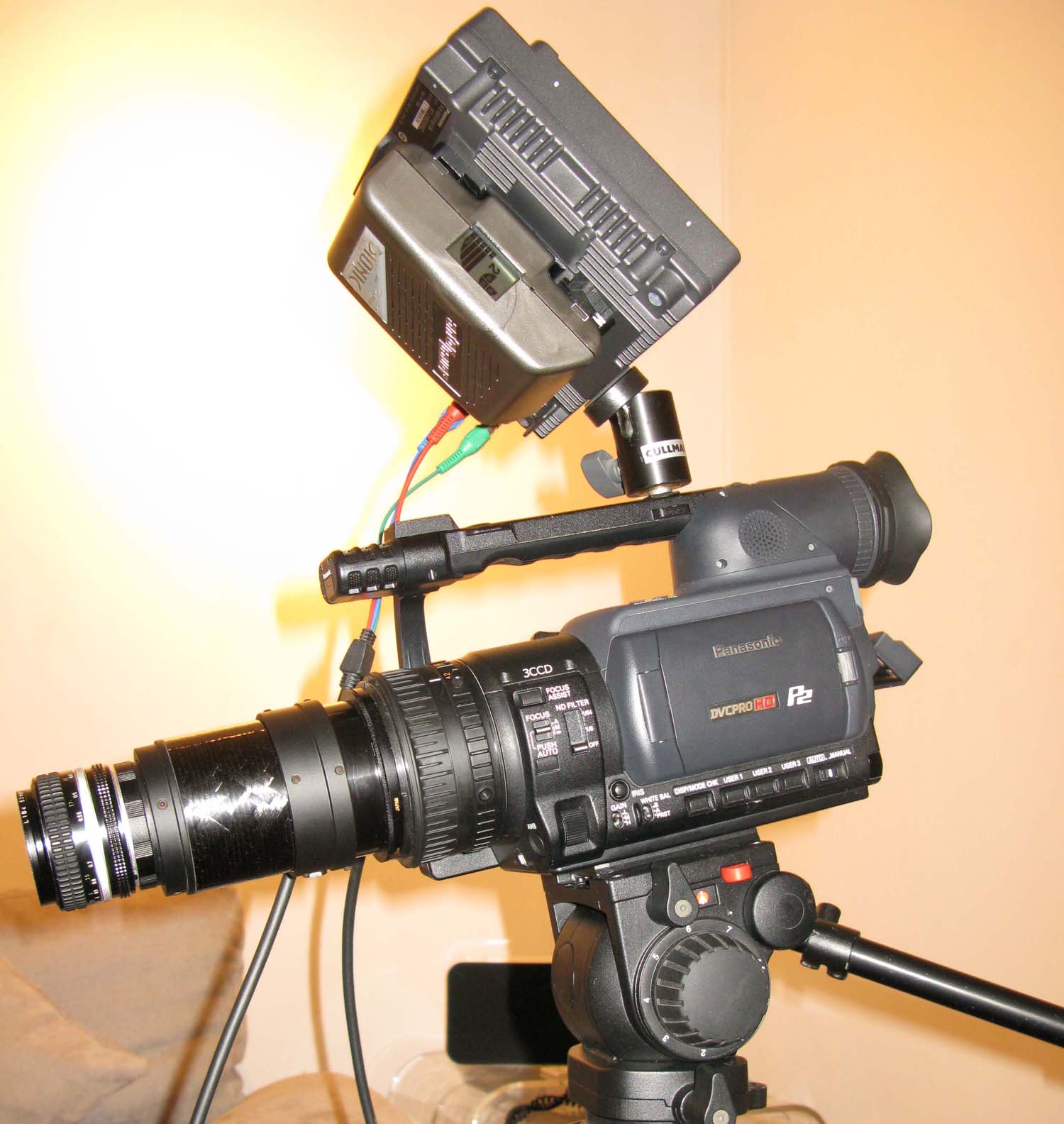

Here is a try on posting pictures of my setup.
EDIT- IT seems it worked!

Sergio,
Thank you for the informative pictures. I didn't think the HVX202 handle could bear the weight of the monitor + AB battery. Apparently, your picture showed me otherwise.

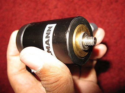

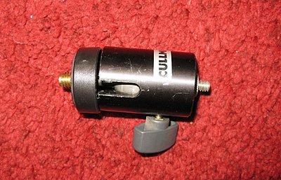

Where did you get that Cullman's ballhead from? I have only seen one side with a hole and the other side a bolt. Yours is both sides having a bolt. Is the ballhead strong enough to hold the monitor without it twisting or swaying from side to side?

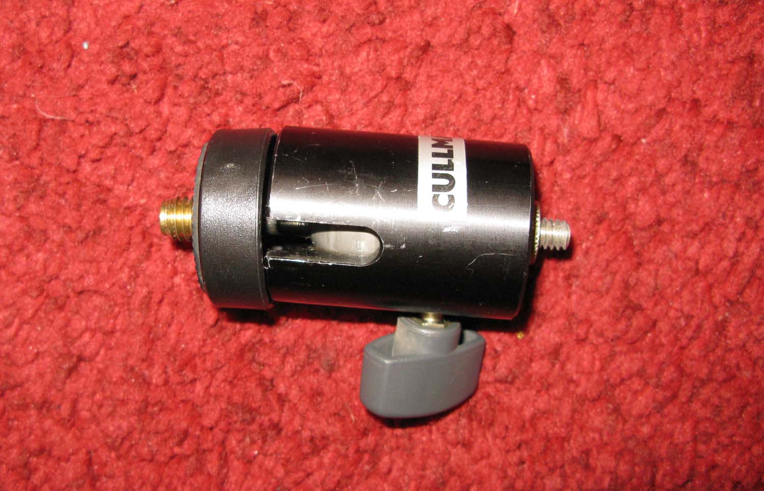

TingSern, basically the cullman has a bolt only on top. The bottom, if you look closely to the picture where I'm holding it, has a screw with 2 heads inserted. So one goes into the cullman, and the other stays for mounting on the HVX200. Cheap and effective solution.
The top screw is large, due to a small to large screw adapter (that's why its gold colored). This solution is cheap, solid as a rock, lightweight, and the Cullman head can securelly hold the monitor+ battery no problem. The trick is on the screw with two heads. the base of the screw and its length is just perfect for the hvx's screw hole. So the whole setup is steady and doesn't shake or is unstable to the sides, due to the small " bump" surrounding the HVX hole. The handle in my view can handle the monitor, but having the battery on it is pushing it...So the belt option for the battery seems like a safer bet.
It can even be handheldable, if you have strong hands, there is... On a glidecam 4000 with smooth shooter, however, its over limit, so I have to find either an assistant to hold the monitor while I fly with the brevis, or its a no go...

Sergio, where did you find that "large screw adaptor" from? I have lots of panball heads (mostly based on Acra Swiss design). I can easily adopt one of them for my HVX - provided I can figure out your "large screw adaptor". Thanks.

The large screw adaptor is a 20 HK dollar iron screw cap that screws on the small screw of your head. You can get this in any electric store or (don't know how to say this in english!) those stores were they have screws, tools for bricolage, etc. How about taking your head with your HVX and the Monitor and see how they figure out a screw on solution? Maybe you print out my pictures, and show to them, they will definetly find a solution for you.
I basically did this and went to one of the oldest Photography shops in town who has lots and lots of support gear. The owner was very helpful and we found out this solution and tried many others...

I found the solution .... simply remove one of my spare Gitzo tripod's screw (that comes with 1/4" and 3/8" together), screw the 1/4" all the way into my Acra Swiss style ballhead, mount the plastic plate in reverse and bolt it down with the nut. Now, the 3/8" thread is protruding from the bottom of the ballhead - I simply screw the 3/8" side into the handle of the HVX202. The wide round plastic plate acts as a stabliser and spreads the weight away from the hole itself.

Sure, Tingsern. The best thing on my setup is that it feels solid and its not putting pressure on the hvx screw hole. Everything is stabillized by the iron "circle" that separates the two screw heads- as you can see from the picture.
Anyway, glad you did it! Its a lot better to have it in camera, imho.
