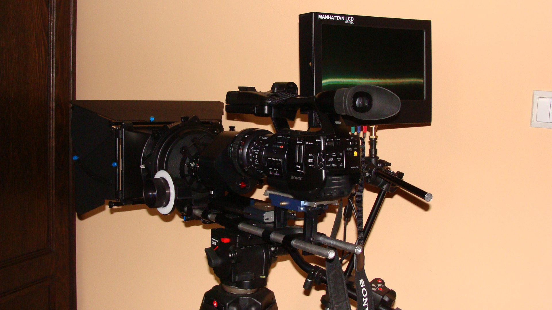

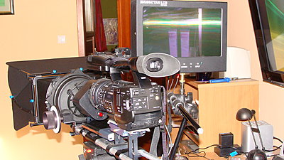

Could you please post a photo of this Manhattan LCD once arrives, mounted with your rig - so i can assess how big it is? I might consider buying one if not too large - its price is definitely tempting. Please post your experience with its picture quality, too.

Here you go, Zsolt :)
As to my opinion on the depicted rig, I'd say that the Redrock Micro stuff is indeed of an exceptional quality, with equally great support from Brian Valente (and others on the RR forum). The Manhattan monitor is also very, very good (as is the Tekkeon battery powering it), and the support from ManhattanLCD's John Reed outstanding.
Unfortunately, I cannot say I'm equally satisfied with the Letus Extreme performance or build quality -a real bummer! Aaron, if you read this, please do something to improve the level of Extreme users satisfaction, instead of just charging more for the Ultimate version (which merely offers improvements the Extreme should have as a standard, in the first place)...
So now the only missing thing I'm still waiting for is the NanoFlash - Mike, I'm counting on you!

I had major issues with edge softness with the RedRock M2 on a Sony EX1 and either the Nikon 85mm f/1.4 or 50mm f/1.4 set to f/2 .

Aaron, if you read this, please do something to improve the level of ( Letus )Extreme users satisfaction, instead of just charging more for the Ultimate version (which merely offers improvements the Extreme should have as a standard, in the first place)...
Piotr, I assume you are referring to the backfocus adjustments, which are badly engineered on LEX - in which case I agree with you!
Alex,
As I wrote several times already in other threads, the image quality I'm getting with the improved Letus achromat for EX1, and my Canon lenses, is marvellous. If I'm not totally satisfied is that a precise opto-mechanical device like this, sitting between your high-quality lens and an even higher-quality camera, should absolutely be built better than the Extreme version is.
The back focus adjustment is a real pain; even if you succeed in getting it to focus at infinity, the GG can change the amplitude and frequency of vibration, making such noise that shooting with an onboard mic is simply impossible. Also, the way adjustment is done will never ensure that you will leave the GG planar with the camera imagers (i.e. normal to the lens axis). This causes picture softness in one corner or even the whole (left or right, upper or lower) extremity of the frame. But above all, the adjustment won't keep - the three GG stands will sooner rather than later change their position in the rubber bushes, and you will lose back focus again, or the noise will increase, or the critical focus will not cover the whole frame - or all of the above... This happens to me constantly; heck - this thing should have a precise, repeatable and permanent adjustment!
Finally, the way Letus Extreme is attached to the thread ring on the camera lens is just pathetic - unstable, flimsy, and above all, unrepeatable. The only contact is the shallow flange, and those pathetic three little screws to keep the 2 heavy and expensive pieces together (camera + adapter) - even on rails, this simply cannot be stiff and precise enough a connection! What I'd expect here is a much longer (or should I say, deeper) contact, and a connection secured by a solid, threaded muff.
Most of the above have been fixed with the Ultimate version, for more than twice the price...
