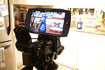

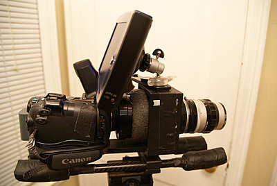

This is the TV:
AUVIO™ 7" High-Resolution Portable Digital TV - RadioShack.com
The mount centers on this inexpensive Targus suction cup camera mount:
Amazon.com: Targus Digital TGT-SP Suction Cup Tripod: Camera & Photo
The suction cup uses a mechanism to attach firmly to surfaces.

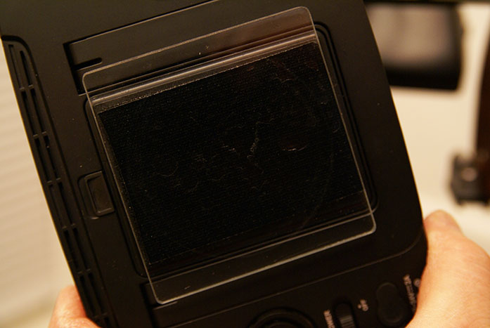

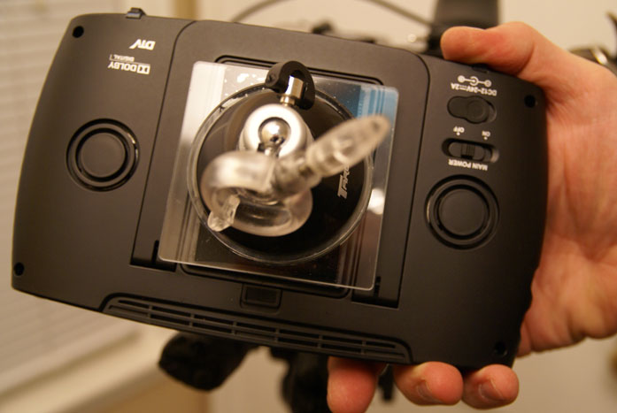

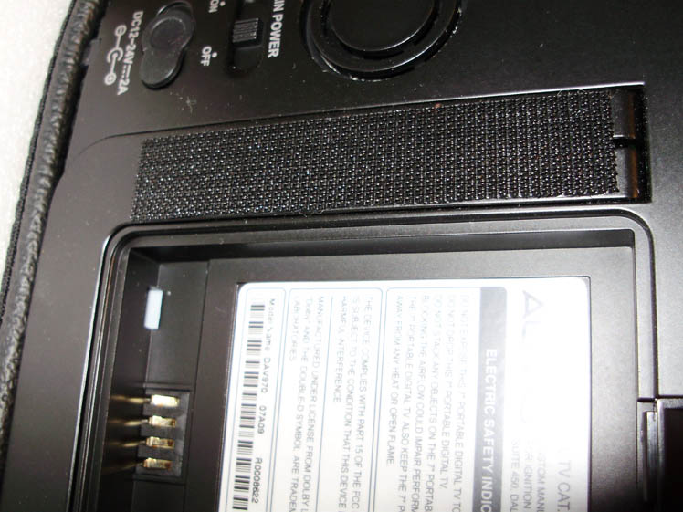

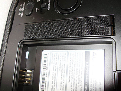

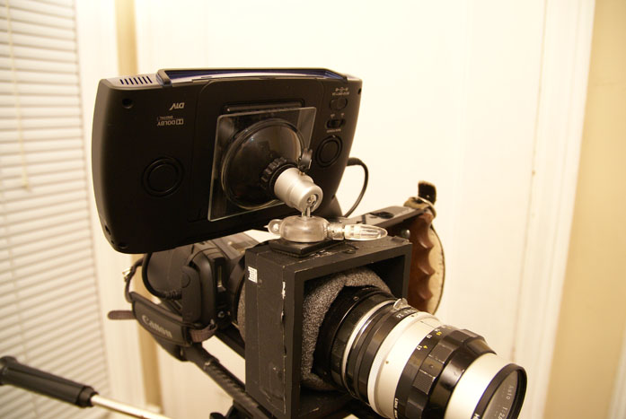

The basic idea is to mount to the battery/battery door on the back of the Auvio, which is the only smooth flat surface. The door measures about 3" x 2.25" and the suction cup is 2.75" in diameter, so another surface must be bonded to the battery that will cover the entire suction cup area.

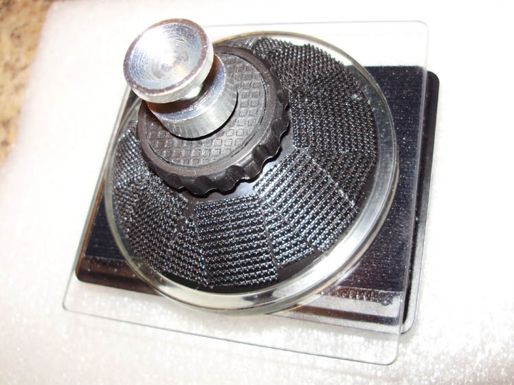

I decided to use a sheet of 3/32" thick glass (cut 3"x3") attached with velcro to the battery. Glass is not porous or grained and makes the best material for an airtight seal for the suction cup. I used industrial strength velcro, 2" wide, from Home Depot.

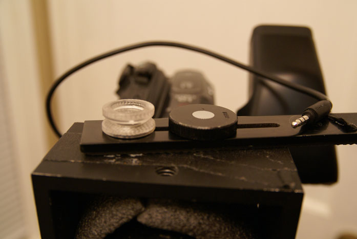

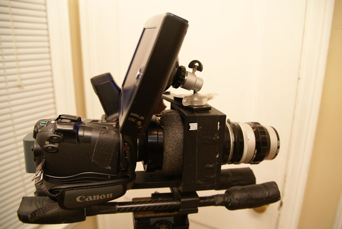

I mount to a flash bracket attached to a modified Shrigg Rig from indifocus (HV30, RNG35, Nikon 105mm, Mamiya Prism Finder).
For storage, I remove the suction cup from the glass. The Targus device has a quick release mounting disk which I leave on the flash bracket. I leave the glass velcroed to the battery. Everything stores safely in a netbook case.
In order to apply appropriate pressure to the battery when attaching the suction cup to the glass, I first remove the battery from the TV. I slightly moisten the suction cup before attaching. I did have the suction cup mount come off once when I failed to apply appropriate pressure when mounting it, so I recommend being attentive. When applied properly the suction cup holds very well to the glass. I plan to do an overnight test and report the results here.
The suction cup isn't a permanent mount so it should probably be removed for storage after a shoot, or at least checked regularly.

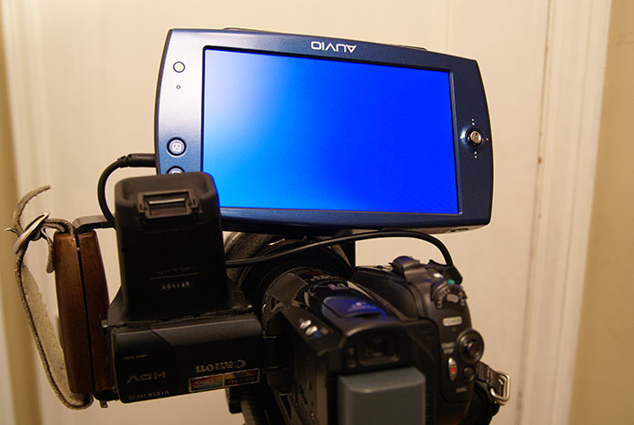

I think it's a clean, elegant, easy-to-adjust solution. It is certainly easy to rotate/flip the unit for use with a DOF adapter. The Auvio is lightweight and compact. I find the resolution to be sufficient for focusing. (I do wear a pair of magnifying diopters regardless the focusing monitor I am using.)
This Auvio is not to be confused with another 7" Auvio TV sold at Radio Shack that is only 480x234.
A word of caution on glass cutting. Be sure to polish the edges and corners with a wetstone remove sharp edges and strengthen the glass.

Some more suction cup mounts:
Suction Cup Camera Mount
Delkin Devices | DDMOUNT MINI Fat Gecko Mini | DDMOUNT-MINI
Suction Cups & Accessories
The only drawback to this set I see is that in a handheld situation I may want to adjust the position of the monitor without setting it down to use the clamp. Perhaps something like this could be used to extend the Targus mount which would allow for one-handed adjustment of the monitor position:

Okay, it passed the overnight test, which included about 90 minutes of handheld use today.

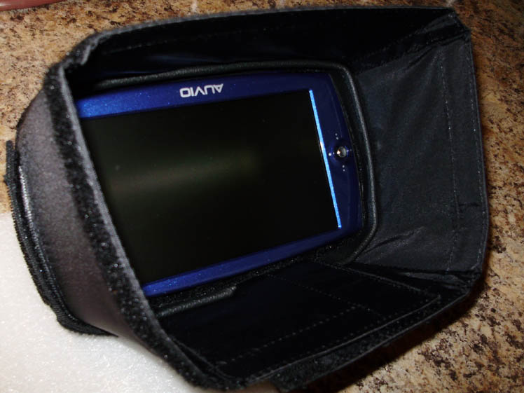

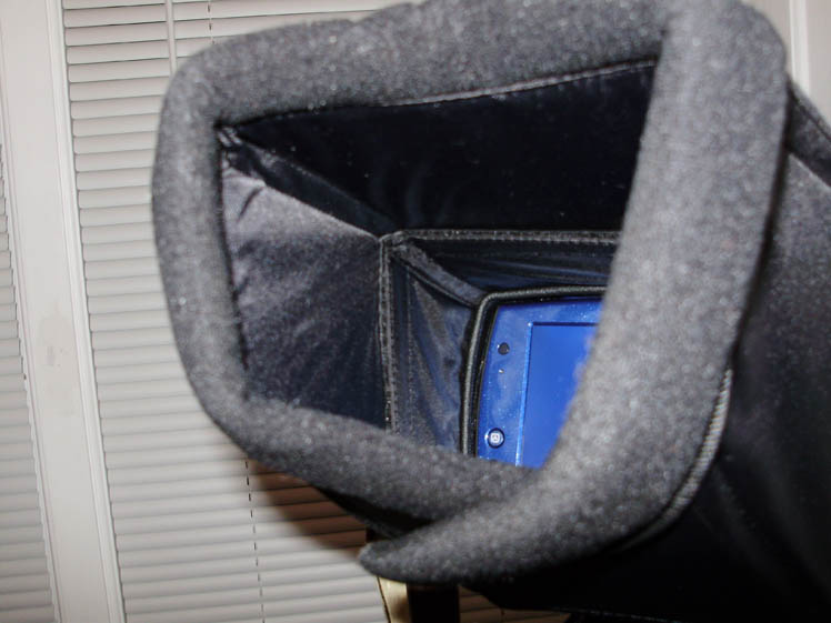

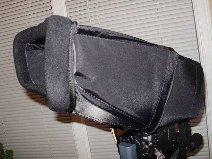

I added this Petrol hood for 7–8 inch monitors:
Petrol | PMH-6 Monitor Hood | PMH-6 | B&H Photo Video

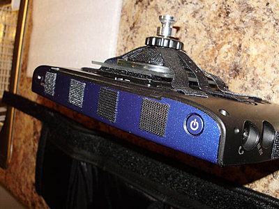

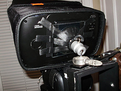

I had to mess with it and added velcro around the front rim of the hood and a few pieces of it on the sides of the TV. I use industrial grade velcro and I use a hair dryer to heat and soften the adhesive.
It probably would have been easier to get this one for 6.5–7 inch monitors but it was unavailable from B&H and I went with the bigger one:
Enhanced View Services, Inc.

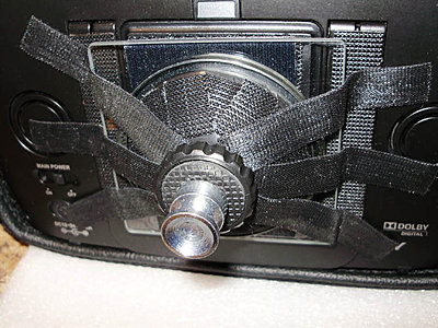

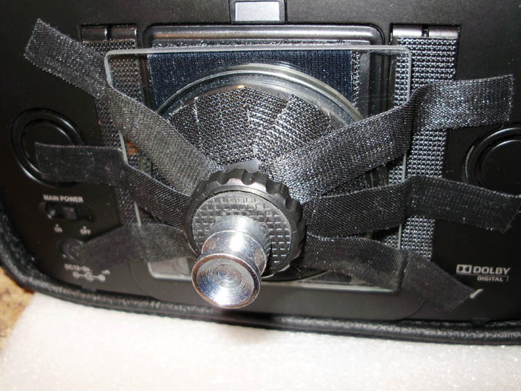

I also added a little security backup to the suction cup using velcro stuck on the back of the cup and on the back of the TV, and six small velcro straps. I am mostly concerned about potentially losing suction in extreme temperature changes. This system is really holding the TV and hood well for long periods under heavy use.
The knuckle I ordered was too lightweight:
Barber Tech | 3KFA.1/4 3-Knuckle Flexi Arm 1/4-20 | 3KFA.1/4

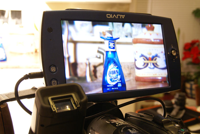

Dave - how would assess critical focus capability with this setup?
Art Varga is offline   Reply With Quote
Old January 6th, 2010, 07:13 PM   #7
Join Date: Jun 2008
Location: USA
Posts: 67
Hello Art. My experience is consistent with what is reported by those using the Sony 800x480 DVD player. Resolution is the approximate equivalent of my camera LCD (HV30).
This is a good solution for me until small HD screens come down in price this or next year. The Auvio is smaller and lighter than the Sony DVD player, and I can usually hit the sweet spot in the short "throw" of the lens's focusing ring between which there is no change in the image at it's apparent sharpest.
Here's a short test I made using the Auvio last night:
I racked from target to target quickly, and now realize I should have lingered longer at each target to make it easier for you to see how well I was hitting the mark. My apologies for that, but I hope you can see some of the hits.
BTW, the Auvio is now $160 at Radio Shack.
(I still really like using the Mamiya prism finder velcroed to the HV30 LCD.)

Originally Posted by Dave Therault View Post
This is the TV:
This is probably too simple, but... Why not stick velcro to the inside of the suction cup and press that to the velcro on the back of the monitor? That 2" industrial stuff should hold up a 30" monitor.
George Strother is offline   Reply With Quote
Old January 13th, 2010, 08:13 PM   #9
Join Date: Jun 2008
Location: USA
Posts: 67
Good thought, George, and you may be satisfied with that method.
I tried that first, but while the velcro has strong grip strength, sticking with the concave cup made the whole thing wobbly, whereas the flat surface of the glass velcroed to the battery over a 6 square inch area is very sturdy, and the suction cup on the glass is similarly sturdy. With this setup there is only a little movement between the glass and the battery, and none perceptible between the suction cup and the glass. I imagine that the torque force applied when a big hood is attached would challenge the method you are suggesting.
Also, it was difficult to flex the cup and stick it, and then to remove it repeatedly, so I decided to use each component as designed.
